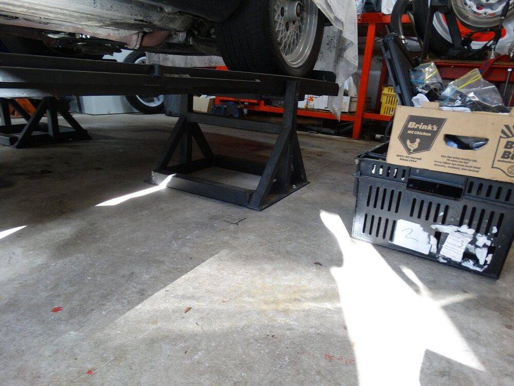

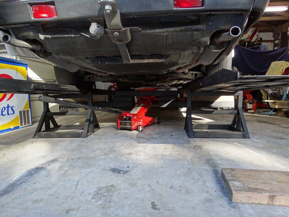

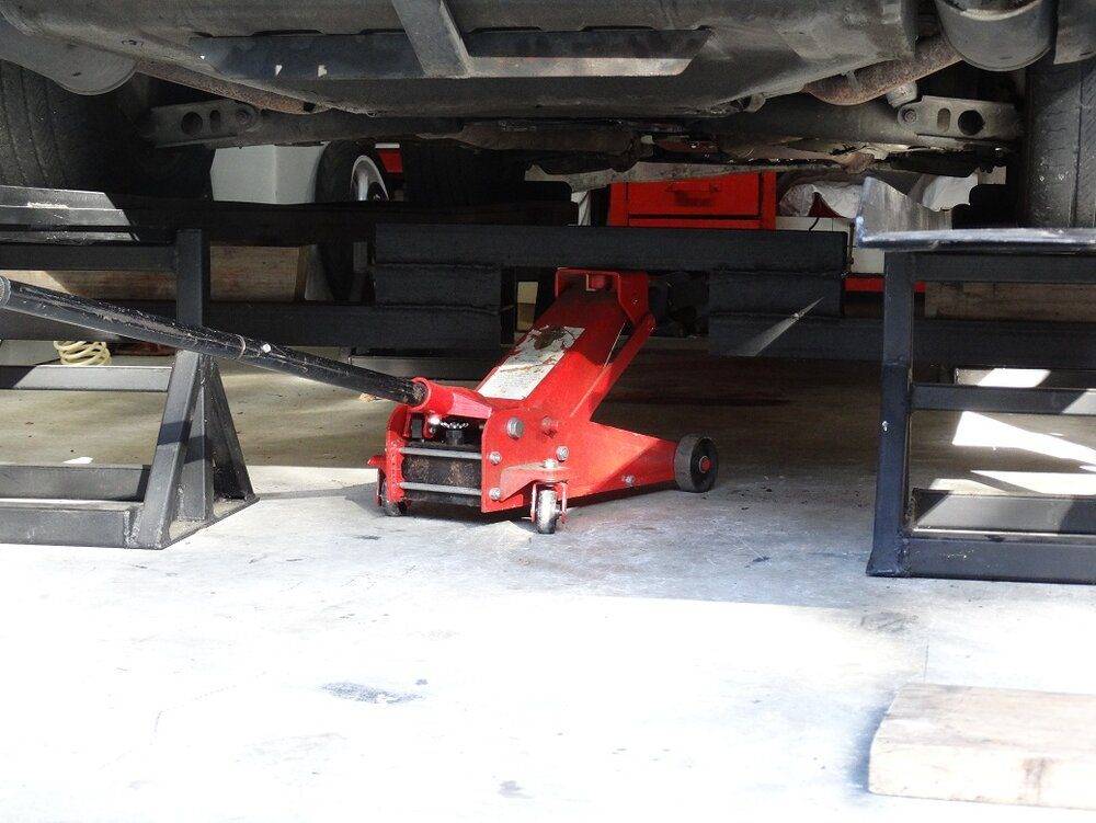

Dukeman
TL;DR

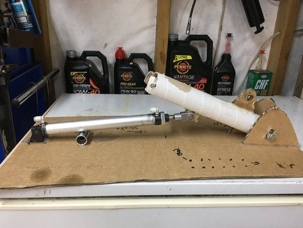

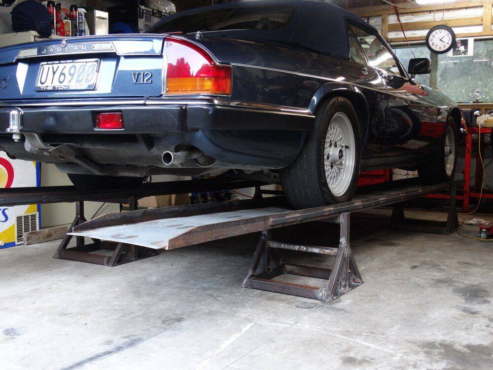

Currently I have to jack the ramps from under the car... no fun.
I currently jack up the end of the ramps using the channel frame and a 3 1/2 ton jack, because of the height of the channel frame I have to have it sitting quite far back under the car for clearance when the ramp is lowered down to drive off.
I have to push the jack a long way under the car to lift up the end. I want to make it easier... cheaper the better as usual. But I am looking at two hydraulic cylinders mounted under the ramps, one each side and use them to lower an arm with a wheel on the underside. This will lift up the ramps high enough to place the support frames under the ends.
I have looked at 2 x hydraulic cylinders...
32mm bore
20mm rod
200mm stroke.
Would these be strong enough? Or would the rods bend?
I have NO idea how to work out how strong the cylinders would need to be.
Also would like to connect them to a hydraulic hand pump or air/ hydraulic pump.
I had a good making a cardboard example to see how it could work.
Any ideas please?

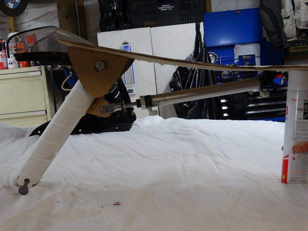

It looks like you will be retracting the hydraulic cylinders to raise the car.
That gives an effective piston area of π x (162 - 102) (that's piston - rod areas)
or 3.14 x (256-100) = 3.14 x 156 = 490mm2, or 4.9cm2, or .76in2.
From the cardboard mockup, when the leg is folded parallel to ramp:
Mechanical DISadvantage is:
cylinder pulling on leg to raise ramp: 7.5 (pulling almost across the leg pivot)
tip of leg to cylinder attach relative to leg length: 5.3
= 7.5 x 5.3 = 39.75 Mechanical DISadvantage
weight on each leg, assume 1000lbs or 454kg
cylinder force needed: 39.75 x 1000 = 39 750lbs, or 39.75 x 450 = 18 047kg
hydraulic pressure needed: 52 300psi, or 3 683kg cm-2
Conclusion: not possible with current or foreseeable technology. :cry:
Oh well; nice thought though!
Cheers,
Tom

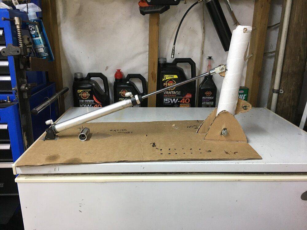

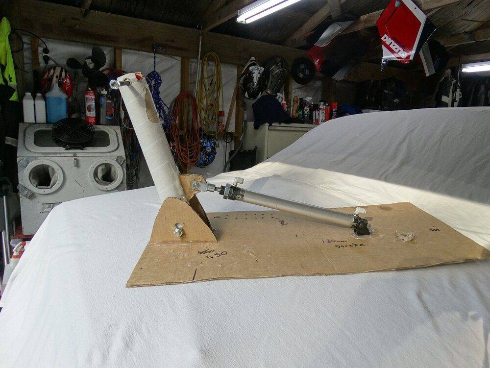

Just to add - I only want to lift and lower the one end the the car drives on to, the front will pivot.
Lift the rear end, remove 2 x supports, lower the rear end and back down and off the ramps.
I do not think pneumatic would have enough power, worked with them for years, but if the hydraulic cylinder pushed the arm down and lifted the ramp... could that work?
I will mock up a sample out of cardboard...
Righty Ho... here is another option using the cylinder to push.
Remember this is upside down and it would be mounted to the underside of the ramp and there would be a wheel on the end of the arm which will push on the ground and lift the ramp.

Dukeman said:
what if I turn the whole thing around so the cylinder is pushing to lift the car?
I did not think about the reduction in force due to the area of the cylinder rod... assuming I am on track?
Yes. You would then need only 70% of the pressure calculated in my post #2.
https://www.physicsforums.com/attachments/img_1626-jpg.262614/
This change, moving the cylinder attachment point further down the leg means you need only 34% of the calculated pressure. Combine the two options for 0.7 x 0.34 = 0.24 (24%) of the pressure calculated in post #2.
12 550psi or 884kg cm-2
Still not practical though. The highest hydraulic pressure I've heard of in use was 10 000psi on a military aircraft; and it took them an extra year or so to get that to work.
There are higher pressures in use (30 000psi and up) for Water Jet cutting of hard materials, but the safety concerns are extreme. A quote from one site on Water Jets: Waterjet cutting is used to cut through extremely hard materials and is fully capable of removing a limb from an inattentive operator.
Even air at 100psi can be dangerous enough. Here in California, Industrial Safety Laws limit the pressure in an air gun nozzle to 30psi when used on an assembly line. (The work-around here has been to put a pressure regulator at each workbench but have a connector before the regulator "For Use By Authorized Personnel Only" o_O)(the 10 000psi hydraulic and 30psi air numbers are several years old and may have changed by now)
The approach by @Ranger Mike (https://www.physicsforums.com/posts/6339717) seems the best bet so far. I suggest you investigate it further (even if you can't use those hydraulic cylinders you already have! 😭 :).
