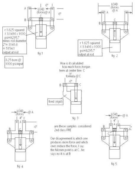

Maybe someone can answer this , at work I have a bet ( lunch ) on principles of leverage when applied from a hydraulic cylinder .
I am going to try and attach a sketch and all I am looking for is the formulas to calculate the forces produced at point A and C .
We both agree on how to calculate cylinder force in extend or retract,but all the formulas that we have looked at do not show how to calculate the force at C on figure 3 using the length between B and C or at point A figs 1,2,4,5
Our disagreement is which one produces more force and which one reduces the force.
I say the fulcrum (moving fulcrum)point is C he says no it is B ((fixed fulcrum)point
the lunch team
  • Five hand-drawn linkage diagrams (fig 1 to fig 5) of hydraulic cylinder mechanisms with labelled points A, B and C, dimensions of 6 and 4 inches, and handwritten notes on squared-radius and psi output calculations.
snakeeyes: You correctly calculated the hydraulic cylinder output force, P = 5154.2 (or 8295.8). The fulcrum appears to be at point B. Point B is an almost stationary pivot point. The force applied to point C on each bar attached at point C is P divided by the number of bars attached at point C. Therefore, in figures 1, 2, 4, and 5, the force applied at point C on each bar attached at point C is 0.5*P; and the gripping force, F, at point A is F = 0.5*P*b/h, where b = horizontal distance from point B to C, and h = vertical distance from point A to line BC. Therefore, in figures 1 and 4, F = 0.5*P*b/h = 0.5*5154.2*6/6 = 2577 lbf. In figure 5, F = 0.5*P*b/h = 0.5*5154.2*6/2 = 7731 lbf. In figure 2, F = 0.5*8295.8*6/6 = 4148 lbf. The force applied at point C in figure 3 is P, and the resulting output force at point C in figure 3 is 5154 lbf. Figures 1 and 2 are first class levers. Figures 3, 4, and 5 are mostly similar to second class levers.

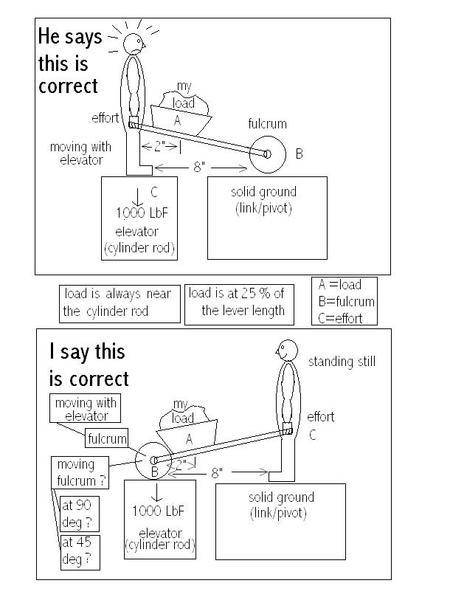

  • Two hand-drawn lever diagrams comparing a person lifting a 1000 LbF elevator load: top labelled "He says this is correct" with fulcrum at the far end and load 25% of lever length, bottom labelled "I say this is correct" with a moving fulcrum at 90 and 45 degrees.
snakeeyes: Why does your second attached file show the elevator pulling downward? Elevators push upward. They do not pull downward. Please correct the diagram, so we could see if your question is understandable. Also, state the direction of motion of the elevator. Third, state whether your second attached file is intended to correlate to a particular figure number in your first attachment; and if so, try to use the same, corresponding point labels (B and C). Or is your second attached file a completely independent example? Fourth, perhaps state what you mean by "90 deg" and "45 deg," which are undefined.
thank you for responding ,
First did or did not the attached file come out as readable or all rough , I opened it and if I had not been the one who drew it I could not tell what it might represent.
as to the other questions: elevator was representing a hydraulic cylinder rod end not really a elevator (just to show movement ), the direction is down , the chamber/cylinder pressure minus the rod diameter equals 1200 LbF downward , no this drawing is different as to the other drawing, I wiil submit the more accurate drawing as related to the real device and how we need to measure the forces with the right formulas , I am getting hungry hope I when the bet.
thanks
The lunch debate team
snakeeyes: The image quality and legibility for all three attached files came out well. The active force, also called the effort, is applied to a movable point on a lever; it is the input force or action. In your case, the effort is the hydraulic cylinder force. A fulcrum is a stationary or almost stationary pivot point. The force at a fulcrum is a reaction force. In your third attached file, the fulcrum is the stationary, right-hand pivot point, as described in post 2 for figure 5. The formula is given in post 2.
