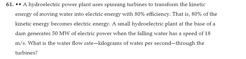

Printed textbook problem 61 about a hydroelectric plant: 80% efficiency converting kinetic energy of falling water to electric energy, 50 MW output at 18 m/s, asking for flow rate in kg/s.
What I attempted to do is
.80(1/2)mv2 = Ee
Where v is the velocity of the falling water, m is the mass of the falling water, and Ee is the electrical power generated by the electric plant.
So then I solved for m since you are given the Ee and the velocity and I got 3.86 x 10e5 kg/s.

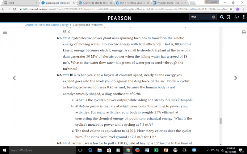

  • Screenshot of a Pearson eText textbook page, Chapter 9 Work and Kinetic Energy exercises, showing problems 61 and 62 about a hydroelectric plant, drag on a cyclist, and metabolic power.
Your number is correct. To be strictly correct you should use dm/dt in your equation instead of m.
But then it would be dE/dt on the other side, assuming E stands for energy, not power.
The OP equation can be justified by prefixing it with "in the time in which a mass m of water passes through".
If E stands for energy, .80(1/2)(dm/dt)v2 = dE/dt is correct.
If Ee stands for power (as indicated by OP in attempt at solution), .80(1/2)(dm/dt)v2 = Ee is correct.
