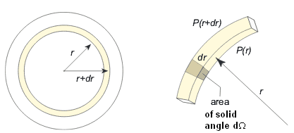

Hello.
In my homework I was given to find a mistake in a derivation of hydrostatic equilibrium of a star.
In contrast to "regular" derivation, where a cylindrical segment is chosen, in HW a segment of sphere is used:
Two diagrams: at left, a concentric circle pair with radius r and r+dr from the centre; at right, a spherical shell segment labelled P(r+dr) and P(r), with thickness dr, a shaded solid angle dΩ and radius r from the centre.
Derivation is given as following:

After going and checking the solution step by step I found only 2 places where error can occur:
1. The origin of the additional term is from the non-equal areas of the segment in [itex]r[/itex] and [itex]r+dr[/itex]. This makes sense, since in "regular" derivation of the equilibrium equation a cylinder is used, and there both areas are equal. In addition, if we make [itex]r[/itex] to be very big (in limit - [itex]r\rightarrow \infty[/itex]) - then areas of outer and inner surfaces will be, indeed, identical, and as supposed the additional term ([itex]-\frac{2}{\rho}\frac{P(r)}{r}[/itex]) will be zero.
I told this to my teacher, but he said that this is not an origin of the problem.
2. So I checked the derivation again and found that in line "c", the term [itex]2r\frac{dP}{dr}\left ( dr \right )^2d\Omega[/itex] cannot be included inside [itex]O\left ( \left ( dr \right )^2 \right )[/itex]. But if I include this term in the derivation, I get:
[itex]g=-\frac{2}{r \rho} P(r)-\frac{1}{\rho}\frac{dP}{dr}-\frac{2}{r \rho}\frac{dP}{dr}dr[/itex]
which gets even worse than was before.
Can someone help me with that? What I'm missing here?
Thanks in advance.
Why are the forces on the other surfaces of the element ignored?
Only radial components are taken:
[itex]F(r+dr)[/itex] and [itex]F(r)[/itex] are vectors in [itex]\hat{r}[/itex] (radial direction).
Gravitational force is of course in [itex]\hat{r}[/itex] direction too.
Why do you think the other surfaces do not contribute a net radial component?
Because 2 other surfaces are in [itex]\hat{θ}[/itex] and 2 additional surfaces are in [itex]\hat{\phi}[/itex] directions and do not contribute to the [itex]\hat{r}[/itex] components. Am I wrong?

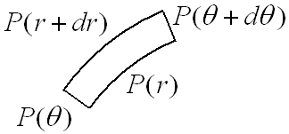

I still don't understand.
Diagram of a curved wedge-shaped volume element with pressure labels P(r + dr) at the outer top corner, P(theta + d theta) at the right end, P(theta) at the lower left end, and P(r) on the inner curved edge.
[itex]F(\theta)\hat {\theta}=P(\theta)\cdot A(\theta)=P(\theta)\cdot \left [\left (d \phi \hat {\phi} \right ) \times \left (d r \hat {r} \right ) \right ]=P(\theta)\cdot d \phi dr \hat {\theta}[/itex]
[itex]F(\theta+ d \theta)\hat {\theta}=P(\theta+ d \theta)\cdot A(\theta+ d \theta)=P(\theta+ d \theta)\cdot \left [\left (d \phi \hat {\phi} \right ) \times \left (d r \hat {r} \right ) \right ]=P(\theta+ d \theta)\cdot d \phi dr \hat {\theta}[/itex]
Still no radial components.
You keep writing the same vector ##\hat \theta## for both sides, while you have been already told they are different vectors. No surprise that you keep getting "no radial components".
The angle between the force on the left surface and the force on the right surface ##\pi - 2 d \theta ##, so the resultant is obviously radial and proportional to ##2 d \theta##.

I think I got your point:
Diagram of a thin wedge-shaped sector with an arc, marking an angular element dθ, with forces F(θ) on one face and F(θ + dθ) on the other, and a red radial arrow labeled Fr.
So,
[itex]F(\theta)=P(r)\cdot A(\theta)=P(r) d \phi dr[/itex]
[itex]F(\theta + d \theta)=P(r)\cdot A(\theta + d \theta)=P(r) d \phi dr[/itex]
This contributes additional force in radial direction:
[itex]F\left ( \theta \right )sin\left (\frac{1}{2}d\theta \right )+F\left (\theta + d\theta \right )sin\left (\frac{1}{2}d\theta \right )\approx \frac{1}{2}d\theta F\left ( \theta \right )+\frac{1}{2}d\theta F\left (\theta + d\theta \right )=[/itex]
[itex]= \frac{1}{2}d\theta P ( r ) dr d \phi +\frac{1}{2}d\theta P (r) dr d \phi=P(r)d \theta dr d \phi[/itex]
Same will be with [itex]\phi[/itex] direction, so to the sum of all forces equation in the my first post I need to add additional force in radial direction:
[itex]F_{add}=2P(r)d \theta dr d \phi=2P(r)dr d \Omega[/itex]
Did I understand it right?
Yes, exactly correct.
