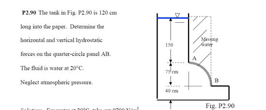

In calculating the vertical force component, you want to find the weight of the missing water.
This should be simple: Find the Volume of the missing water and multiply by specific weight.
Why is my volume calculation incorrect? I am using the volume of the rectangular prism whose top coincides with the surface and whose base coincides with B. Then I subtract the volume of the quarter cylinder:
[tex]V_{Tot}=V_{rect}-.25V_{cyl}[/tex]
[tex]V_{rect}=(1.5+0.75)(0.75)(1.2)[/tex]
[tex].25*V_{cyl}=.25*(\pi (0.75)^2(1.2)[/tex]
But this does not give the correct volume. The solution says to use:
I am failing miserably to see how my method is different from theirs? Am I messing up a dimension here?
Aaahhhhhhhh! My brain!
Edit: How does what they wrote even make any sense?
The first term has dimensions of m^3 and the second has dimensions of m^2 !
Not to mention, if you put those numbers into your calculator they do not equal what they are saying they equal. WTF
It looks like the second term in their solution has a typo: They left off the factor of 1.2m.
Yeah. I think that makes it equivalent to mine if you tack that on.
