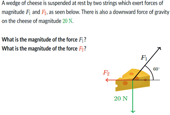

Example 2: String cheese A wedge of cheese is suspended at rest by two strings which exert forces of magnitude F1 and f2 as seen below. There is also a downward force of gravity on the cheese of magnitude 20 N What is the magnitude of the force F1? What is the magnitude of the force F2?

Shouldn't ay be ax?
Why? The 20N is a vertical force, and ##F_1\sin(60°)## is the vertical component of ##F_1##.
Are you saying o or F1Y = 20N? I don't understand why. Can someone explain?

What is the net vertical force on the wedge?
Sorry I used a old account to originally respond. The answer is the net force is 0.

Yes, but what vertical forces on it sum to that?

That wedge of cheese is hanging at rest, according to the problem.
Therefore, forces in all directions cancel each other.
If you define axes x and y as to be aligned with F2 and F4, then you need to decompose F1 in its projections on each of those axes: F1x and F1y.
You should remove that F3 from your schematic, since it does not exist.

How can you ignore F3? It can range from 0-20N depending on F1Y. F1Y can also range from 0-20N depending on F3.

The cheese is not resting on a horizontal surface so there is no upwards normal reaction force (unlike a piece of cheese on a table foe example).
There is no vertical string, so there is no upwards pull from the tension a vertical string.
So there is no upwards force, F3, acting on the piece of cheese. F3 should be removed.
There are 3 forces on the cheese:
F1 - the pull (tension) of the right-hand string on the cheese, at 60º to the horizontal;
F2 - the pull (tension) of the left-hand string – horizontally to the left;
20N - the weight of the cheese (the downwards pull of gravity)
If you think there is another force, F3, what is producing this force?

Thanks I get it now.
