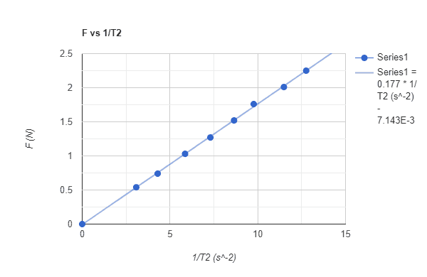

I am writing up a lab report on Centripetal force. One thing I have to do is graph Force vs 1/(Period squared). What would be the unit of the slope of this graph?
The force is in Newtons and the Period is in seconds.
Scatter plot titled F vs 1/T2 with nine blue points lying close to a straight fitted line, F (N) on the vertical axis from 0 to 2.5 against 1/T2 (s^-2) on the horizontal axis from 0 to 15; legend gives the fit as Series1 = 0.177 * 1/T2 (s^-2) - 7.143E-3.
Take the equation that you are plotting.
Replace ##F## with ##y##,
Replace ##\dfrac{1}{T^2}## with ##x##.
It should now look like ##y=\text{something}*x##. The slope is something. What are its units?
