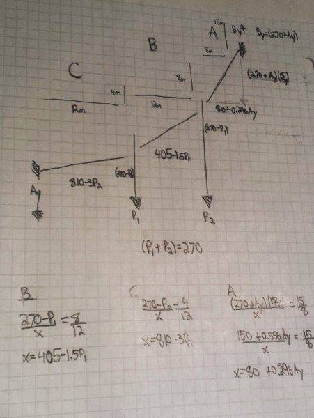

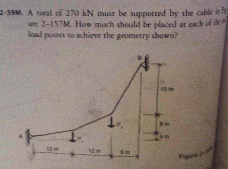

I have come to the point in the equation where I need the moment equation to solve for Ay. I am not sure how to get By in term of Ay though. The moment equation I get for Ay is:
∑Mb = 8(-P2) - 20(-P1) - 32(Ay) + 15Ax
I know P1 = 270 - P2
However I am not sure if I even have Ay and Ax right in the ∑Mb equation. Where do I go from here?

Because of the boundary conditions in points A and B, TotalMb and TotalMa should be zero. You could write two different equations from here, and 2 more equations comes from TotalFy and TotalFx. And here you go, you have 4 equations and 4 unknowns, which you can solve for all the unkowns
Do i have the ΣMb equation right if I wrote it equal to 0?
Ok so for the Fy = 0 equation it would be -Ay -P1 - P2 +By = 0
For the Fx = 0 equation it would be -Ax + Bx = 0 (However, is Ax and Bx the total force across the cable or are the broken up into three components?)
