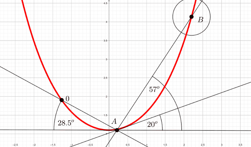

I want to know if the sketch I've drawn of the catenary suits the exercise

Finally, the calculus that inspired the Geogebra file I've drawn is this:
If ##s_B=100##, ##l(AB)=70##, then
$$s_B\,:=\displaystyle\int_0^{x_B}\sqrt{1+[y'(x)]^2}\,dx=\displaystyle\int_0^{x_A}\sqrt{1+[y'(x)]^2}\,dx+\displaystyle\int_{x_A}^{x_B}\sqrt{1+[y'(x)]^2}\,dx\Longrightarrow{s_B=s_A+l(AB)}\Longrightarrow{s_A=100-70=30}$$
There goes. No preview.

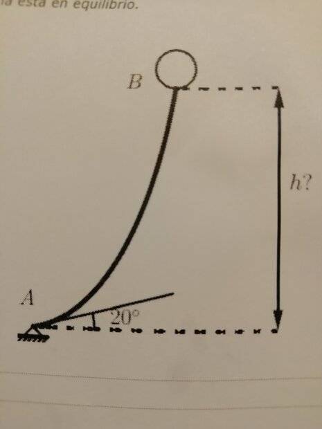

mcastillo356 said:
The vertical component of the force exerted on the balloon in the figure is 500N.
What force is this?
There would be three vertical forces on the balloon, no? The weight of the balloon, the buoyant force on the balloon and the vertical component of the force from the cable.
Since the system is in equilibrium, these are in balance.

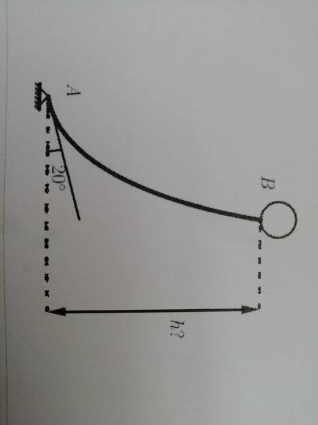

The vertical component of the force from the cable would be downwards and must be less than the weight of the cable (unless the diagram is misleading, and ought to show the cable rising above its tether, not hanging from it).
The diagram is twisted to the right in the original post. It should have been like this:
Ok, but that can only be in equilibrium if there is some other horizontal force, a breeze perhaps, on the balloon. So I assume the task is to find that force.
You have the right answer for ##T_{Bx}##, but it can be derived in three or four lines, without needing to know the equation for a catenary.
Your diagram appears to put both the anchor point, A, and the origin for the catenary equation on the x axis. This is not possible. Maybe it would be clearer either by making the diagram larger or distorting the scale.

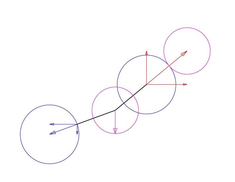

Lnewqban said:
How?
How? . . . indeed .
How are ##\displaystyle T_{By}## and ##\displaystyle T_{Ay}## related ?
How are ##\displaystyle T_{Ax}## and ##\displaystyle T_{Ay}## related ?
How are ##\displaystyle T_{Ax}## and ##\displaystyle T_{Bx}## related ?
SammyS said:
How? . . . indeed .
The axial tension of the rope at B must be equal to the axial tension of the rope at A plus the weight of the rope.

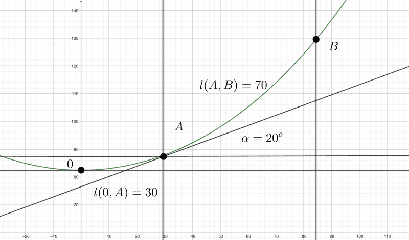

Everything gets fixed, I mean well defined, if we set the proper function that suits the correct diagram, ie, ##f(x)=82.42\cosh{\cfrac{x}{82.42}}##. Provided a cientific calculator, ##x_A=29.37##, and ##x_B=84.44##; so we conclude
$$L=\displaystyle\int_{x_A}^{x_B}{\,\cosh{\cfrac{x}{82.42}}\,dx}\simeq{70}$$
There goes, no preview
