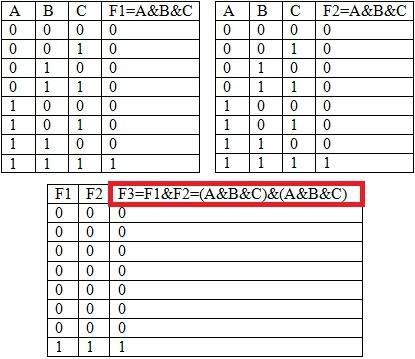

Hi JJBladester. The dot is AND, I presume? Could you draw a truth table to test whether A.B.C = ❲A.B.C❳.❲A.B.C❳

Hi JJBladester. The dot is AND, I presume? Could you draw a truth table to test whether A.B.C = (A.B.C).(A.B.C)
I use the middle dot for AND and the plus symbol for OR. Some authors use the ampersand symbol or even a period to mean AND.
I've drawn the truth table below and it appears that idempotency is valid for multi-variable terms because F3=F1&F2. Am I correct?
My professor claims that "the theorem is for single input and single output logic" but I don't know if that's correct because of my table above...
You know that [itex]X \land X = X[/itex] is true, so why not just let [itex]X = A \land B \land C[/itex]?

You know that [itex]X \land X = X[/itex], so why not just let [itex]X = A \land B \land C[/itex]?
I believe what you suggested is valid. This is why I am utterly confused why my professor said that the idempotency theorem is "for single input and single output logic".

Your theorem states that [itex]X \land X = X[/itex] is true for any X, where X is a variable that has a truth value. [itex]A \land B \land C[/itex] has a truth value so it follows that [itex](A \land B \land C) \land (A \land B \land C) = A \land B \land C[/itex].
It looks like you have it all figured out.
