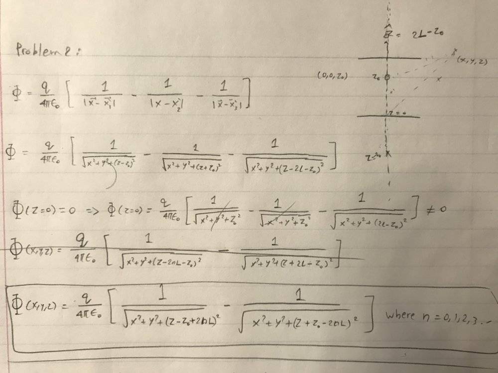

Handwritten derivation titled Problem 2 showing image charge potentials: a diagram of a charge q at (0,0,z0) between planes at z=0 and z=2L, and the boxed result Φ(x,y,z) = q/(4πε0)[1/sqrt(x²+y²+(z−z0+2nL)²) − 1/sqrt(x²+y²+(z+z0−2nL)²)], where n = 0, 1, 2, 3.
I'm sure my solution is wrong because of Φ(z=0) ≠ 0
I searched the internet for a similar problem but I couldn't. Any help will be appreciated.
Each mirror image charge in one plate needs to be mirrored in the other plate, leading to an infinite series.
Can you tell me the series or how the answer look like
http://physicspages.com/pdf/Griffiths%20EM/Griffiths%20Problems%2003.35.pdf
