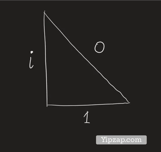

Is this geometry valid?
I posted this in the Lame Math thread, but it's got me thinking.
Handwritten right triangle on a dark background with vertical side labeled i, horizontal side labeled 1, and hypotenuse labeled 0.
Is there any validity to this? Or is it really just a mathematical trick?
Naively, I see that i2 + plus 12 does equal zero2.
But does this have a meaning?
I know one can treat the imaginary number line as just another axis like the reals, but does that mean this does represent a triangle in the complex plane with a hypotenuse of length zero?

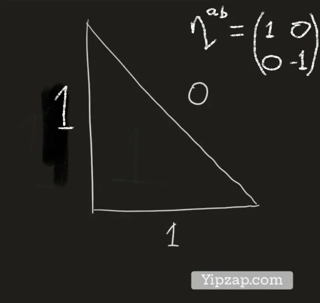

Ibix offered a rendering of the diagram using what I assume is matrix* notation:
Handwritten right triangle with legs labelled 1 and 1 and the hypotenuse labelled 0, next to the metric matrix eta^ab equal to [[1, 0], [0, -1]] in white on a dark background.
which I assume makes the apparent paradox go away, but does that mean the first diagram is not valid?
A triangle in the complex plane would have the lengths of all of its sides as real numbers; i.e., as the magnitudes of the various quantities. ##|i| = 1##.

DaveC426913 said:
I suppose it is theoretically possible to have a triangle with zero length hypotenuse
If both legs are equal in size and one lies on top of the other, the hypotenuse of such a triangle would be zero, but that's not a very interesting triangle.

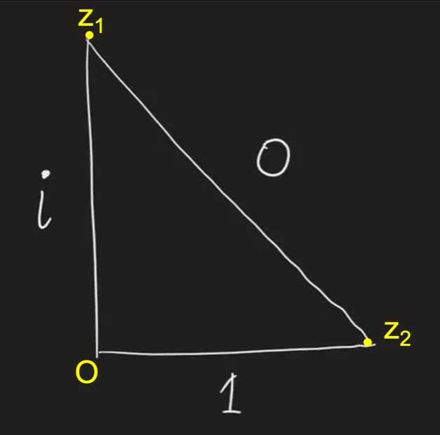

The problem here is, that ## i ## is not a length. If you write it as real vectors like in the Gaußian plane of complex numbers, then it becomes wrong. If you consider it as a complex equation, then it is correct, but lacks the interpretation in the real world.
Hand-drawn diagram of a right triangle with vertex O at the origin, z1 at the top on the vertical axis labelled i, and z2 on the horizontal axis labelled 1, with the hypotenuse joining z1 and z2.
You have two vectors in the complex plane:
##Z_1=(0,i)## and ##Z_2=(1,0)##.
Noting that ##Z_1-Z_2 = (-1,i)##, the magnitude of the hypotenuse squared is
##|Z_1-Z_2|^2=(-1,i)^*\cdot(-1,i)=(-1,-i)\cdot(-1,i)=1+1=2.##
This is the sum of the magnitudes-squared of the sides, ##|Z_1|^2+|Z_2|^2.##

That's one representation of Minkowski geometry, where the vertical axis is time and the horizontal axis is spatial. The spacetime distance in ##c =1## units is given by:
$$(\Delta s)^2 = -(\Delta t)^2 +(\Delta x)^2$$This is sometimes represented using "imaginary" time.
PS the paths of zero distance are those followed by light.

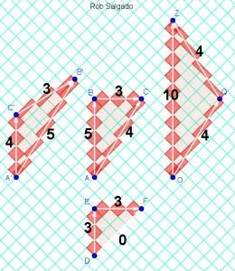

As others have said, the 0-hypotenuse could suggest a lightlike vector in special relativity.
I don't use complex-numbers in special-relativity.
Below, I use real numbers with a Minkowski spacetime metric.
The vertical-3 is for a timelike-vector and the horizontal-3 is for a spacelike vector.
Four geometric figures on a rotated grid: triangles ABC, BCD-style right triangle with legs 3 and 4 and hypotenuse 5, a right triangle with legs 4 and 3 and hypotenuse 10 labeled, and a degenerate triangle D-E-F with sides labeled 3, 3 and 0.
(The segments count the number of light-clock diamonds along the segment.
The choice of which diagonal distinguishes timelike from spacelike.
All light-clock diamonds have the same area... and are traced out by a standard light-clock carried by the piecewise-inertial observer.
The square-interval is the area of the causal-diamond between two events. It is zero for DF since the diamond is degenerate.)
Try Triangle-4 (You may have to scroll down.) Use the tool in Geogebra toolbar to decorate a segment with light-clock diamonds.
You can drop your own endpoints. Return to the cursor in the toolbar to move the endpoints of your segment.
