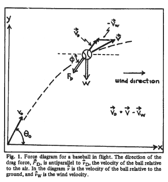

I recently read that the impact of air resistance on the horizontal range increases as the launch angle increases (http://moodle.davidson.edu/moodle2/pluginfile.php/121168/mod_resource/content/2/Brancozio%20fly-ball%20paper.pdf). A graph depicting this is attached. Is there a reason for why this is? I'm not a very good mathematician so it would be great if the explanations didn't involve too much calculus / are mainly qualitatitive (although I do understand a bit of differentiation and integration)

I think you are looking at it backwards, 0 is straight up and 90 is horizontal in your baseball example chart. 90 degrees isn't included in the chart because "grounders?" don't fly very far...

In the document it refers to angles above the horizontal:

It appears to contradict actual physics then, because at 10 degrees just above horizontal at 60 mph the baseball would travel 95 percent of the distance in air than it would in vacuum according to the chart.
