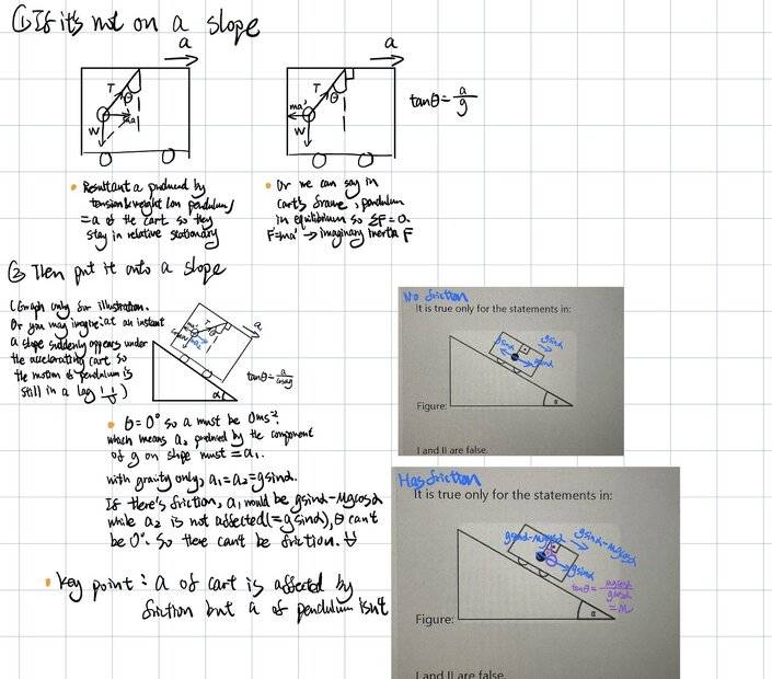

(CESGRANRIO-RJ) In the figure, the cart moves along an inclined plane, subjected only to gravitational interactions and the surface of the inclined plane. Stuck to the cart's ceiling, there's a simple pendulum whose wire is perpendicular to the system's direction of movement.
The following statements are made:
I) The cart is descending the inclined plane.
II) The cart's movement is uniform.
III) There's no friction between the cart and the plane.
It is true only for the statements in:
Figure:
I and II are false.
III is true
I can't prove III is true in a way that makes sense.

The pendulum is like an accelerometer. It indicates the direction opposite to proper acceleration, or the acceleration relative to a free falling frame, where the contact force accounts for all acceleration. If the pendulum is perpendicular to the incline the contact force has only a normal component.

Tried to prove it from scratch, so I hope it makes sense. PS I guess the expression of 'no friction' shall be referring to 'no sliding/no sliding friction' between slope&wheels. Otherwise the wheels would be useless, though results won't be affected physically either way.
Yes, it doesn't matter what kind of friction. In fact, any external force on the cart, that has a component parallel to the incline, and is not a mass-proportional body-force (like gravity), will make the pendulum deviate from the indicated normal direction.
Are you suggesting that static friction is ok, as long as there is no axle friction?
Not so. Even if the wheels are rolling without frictional loss, their moments of inertia would reduce the linear acceleration, deflecting the pendulum from the shown angle. So yes, the wheels need to be frictionless against the plane, and therefore useless.
Useless or massless (or at least have all mass concentrated at the centers and thus no rotational inertia).
