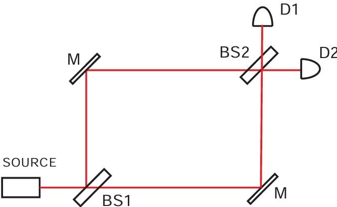

Hi people :)
On an electronics forum, I began a discussion of laser interferometers.
A correspondent's theoretical analysis of the Mach-Zehnder interferometer contains the following assertion:
"The scattering of a photon into one or other arm at BS1 induces by reaction a fluctuation in the re-radiation field,& it is this that interferes with the photon at BS2."
Everything else that my correspondent said seems to make good sense to me, but this particular assertion troubles me because it seems to call firstly for the collapse of the photon in 1 and only 1 path from the first beam splitter, and secondly this collapsed wave interferes itself as a non-collapsed entity.
... I'm confused?
(I guess you can see why I thought it might be better to take this question to a physics forum.)

You may be thrown off by the word "scattered". BS1 will pass and reflect each photon. So each photon is directed to both M's.
Also, the way that is phrased, you might think that something other than the path is different for those two paths. In particular, is it saying that a re-radiation field is interfering with a photon? To be clear, however you describe the photon that reflects from one of the M's is a suitable description for the other - because, after all, it's the same "re-radiation field" or "photon". Only the path is different.

You will be using a laser in you interferometer. What the atoms are emitting are photons of a particular wavelength - small packets of energy of uniform size. If you were trying to understand simple optics, your notion of photons teaming up to for a wavefront would be fine. But your interferometer will do its thing even when the photons are produced at very slow rates - like a few per second - too few to team up to form anything.
Each of these photons is a wave front - and once it passes through the first beam splitter, it is two wave fronts.
After the second beam splitter the fronts recombine. Our detector should be a surface - when the wave front reaches the screen, the location of the photon will be at one of the lighter spots of an interference pattern. The interference pattern itself can only be seen after many photons have gone through this process - each one picking some random brighter spot on the screen.
