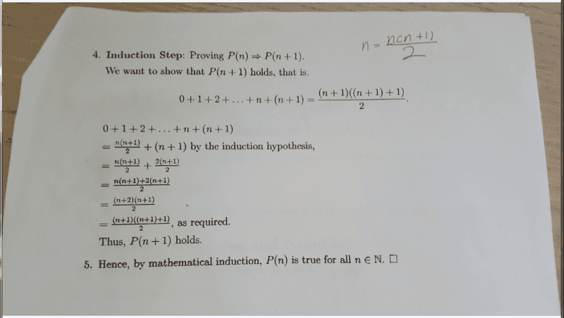

I'm on the 3 line where my Prof. combines both equations, I'm confused on what my equation should look. Her's was (n+1)(n+1)+1)/2

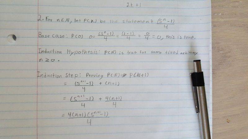

Saying that "4 divides [itex]5^n- 1[/itex] is NOT just a "reference" to [itex]\frac{5^n- 1}{4}[/itex]! It is the statement that [itex]\frac{5^n- 1}{4}[/itex] is an integer. That is, [itex]\frac{5^n- 1}{4}= k[/itex] for some integer k. Further the "n+1" form of the formula is not [itex]\frac{5^{n+1}- 1}{4}+ (n+1)[/itex]. I don't where you got that additional "(n+1)"! Replacing n by n+1 in [itex]\frac{5^{n}- 1}{4}[/itex] is just [itex]\frac{5^{n+1}- 1}{4}[/itex].
Now, of course, you want to "algebraically" go back to the "[itex]5^n[/itex]" and to do that use the fact that [itex]5^{n+1}= 5(5^n)[/itex].
It will be helpful to use [itex]5(5^n)- 1= 5(5^n)- 5+ 4[/itex].

You can write 5n+1 as 5 * 5n, and 5n+1 - 1 = 5 * 5n -5 +4 = 5(5n-1) + 4.

Sorry, I just noticed this but should my equation be 4 l 5^n-1 or is what have okay?
Yes. As 5n-1 is divisible by 4 , the first therm of 5(5n-1) + 4 is divisible by 4, and the second term is just 4.
"4 l 5^n-1" is NOT even an equation!
Okay sorry, I'm a bit confused now. So (5^(n)-1)/4 is correct, right ? And would I follow what my prof. did, so I set my work for n+1 to 5(5n-1) + 4 or is that the induction step?

I think that you have to go from the fact that if (5^n)-1 is divisible by 4 then (5^n)-1=4k where k is a constant. Now, how can you apply this to 5((5^n)-1)+4?. Think of substitution
