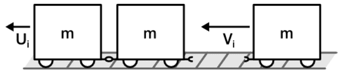

Diagram of three identical railway carriages labelled m on a track, with the left two moving left at speed Ui and the right carriage moving left at speed Vi, before collision.
A railway carriage with a mass m = 2.45×104 kg is initially traveling to the left with a speed Vi = 3.33 m/s. It collides and couples with (get stuck to) two identical railway carriages move to the left with a speed of Ui = 1.69 m/s.
1. What is the speed of the railway carriage after the collision? (give a negative answer if the speed is to the right.)
2. How much kinetic energy is lost in this collision?
P = m1v1 + m2v2
KE = 1/2mv2
KE (before collision) = 1/2m1v12 + 1/2m2v22
KE (after collision) = 1/2(m1+ m2)vf2
1. P = (2.45×104 x 3.33) + 2(2.45×104 x 1.69)
= 1.6x105 kgms-1
∴ P = 1.6x105 = (m1 + 2m2)vf = 7.35x104vf
vf = (1.6x105) / (7.35x104)
vf = 2.18 m/s
2.
KE (before collision) = 1/2(2.45×104 x (3.33)2) + 1/2(2(2.45×104 x (1.69)2)
= 2.06x105 J
KE (after collision) = 1/2( 2.45×104+ 2(2.45×104) ) x (2.18)2
= 1.75x105 J
KE lost = 3.1x104 J
Thank you for any help :)
So I assume my working out and answers are correct?
