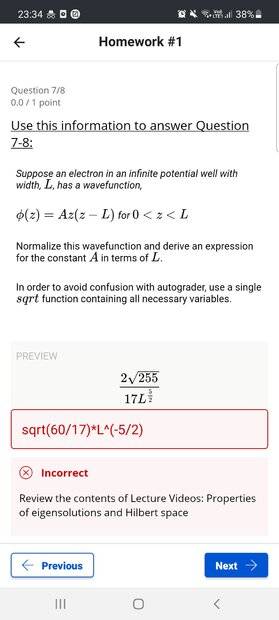

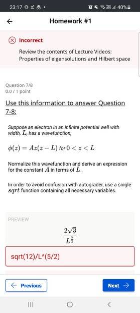

Suppose an electron in an infinite potential well with width, L, has a wavefunction,
ϕ(z)=Az(z−L) for 0<z<L
Normalize this wavefunction and derive an expression for the constant A in terms of L.

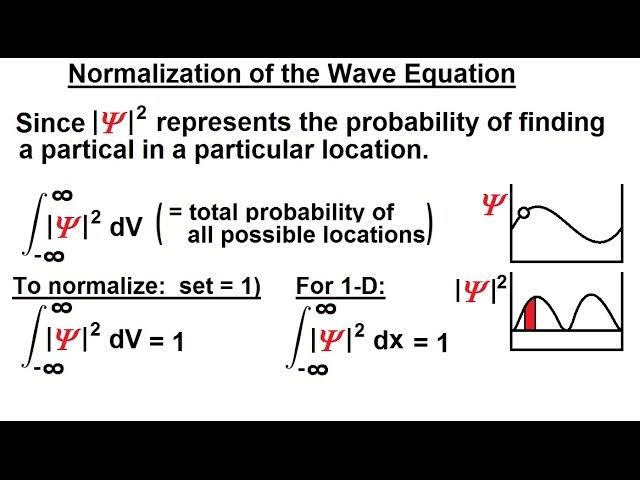

∫|ψ(x,t)|^2dx=1, integral lower bound: minus infinity
Upper bound: positive infinity
I have attached my attempt and proof that my attempts were incorrect.
  • Slide titled Normalization of the Wave Equation: since |Psi|^2 is the probability of finding a particle in a location, the integral from minus infinity to infinity of |Psi|^2 dV equals total probability, set to 1 to normalize; for 1-D, the integral of |Psi|^2 dx equals 1, with a graph of Psi in a well and a graph of |Psi|^2 with a shaded region.

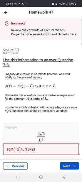

  • Screenshot of an online homework page showing Question 7/8 marked Incorrect, with the wavefunction phi(z) = Az(z - L) for 0 < z < L to normalize, a preview of 2 sqrt(3) / L^(5/2), and an entered answer sqrt(12)/L^(5/2).

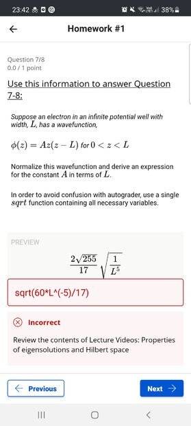

  • Screenshot of an online homework page, Question 7/8, showing a wavefunction normalization problem with the preview A = 2 sqrt(255)/17 times sqrt(1/L^5) and an entered answer sqrt(60*L^(-5)/17) marked Incorrect.
According to the homework guidelines you must make your best attempt at this before we can help.
Your method is fine. Double check your final calculations- using ##60## as a common denominator, perhaps.
Yeah, doesn't work. Please do provide your solution.

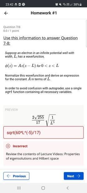

Screenshot of an online homework question on normalizing the wavefunction phi(z) = Az(z - L) for an electron in an infinite potential well, with a preview of the answer 2 sqrt(255) / (17 L^(5/2)) and an 'Incorrect' feedback message.
Ashish Somwanshi said:
Yeah, doesn't work. Plz do provide your solution.
This is my final attempt despite using 60 as common denominator.

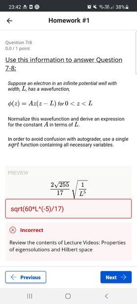

  • Screenshot of an online homework question showing a preview of a wavefunction normalization answer, 2 sqrt(255)/17 times sqrt(1/L^5), with the submitted input sqrt(60*L^(-5)/17) marked Incorrect.
Okay, let's try this again. ##\dfrac{1}{5} - \dfrac{2}{4} + \dfrac{1}{3}## is what?
-Dan
-Dan
Sorry, I don't understand how to add three fractions using common denominator, in my first attempt I did the old way but still incorrect. Plz do provide the solution if anyone can solve their way. Either the autograder must be faulty or something I must be missing...
-Dan
It's 1/12 according to evaluating two fractions one at a time.
No, we do not provide solutions. You really don't understand how to add those fractions? Also, please do not use text speak at PF like "please". Thank you.
I will redo the solution as I have made silly mistakes in evaluating the fractions...Thanks for spotting it.
Guys, Thank you soo much. I've got a passing grade. It is mind boggling to see myself perform childish mistakes doing advanced quantum physics. I am currently analyzing reasons responsible for such performance.
