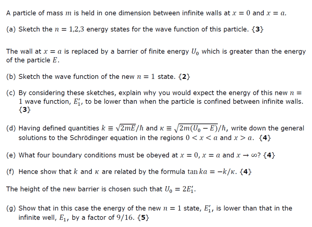

Hello folks,
A bit stumped with the following question:
Consider a potential well with an infinite wall at x=o and a finite wall at x=a. The height at x=a is such that U0=2E1' where E1' is the energy of the particle's n=1 state in this semi-infinite well.
How can one show that E1' is lower that E1 (the energy at n=1 for an infinite well) by a factor of 9/16?
Any thoughts folks?
Sketch the first few eignstates for each case...
As a starting point, the n=1 state energy E1 of a particle with mass m in an infinite well is given by:
$$^{E_{1}}=\frac{h^2}{8mL^2}$$​
So the sticking point is how to calculate an energy value for n=1 E1' when the barrier at x=a is U0=2E1', such that:
$$\frac{^{E_{1}'}}{E_{1}}=\frac{9}{16}$$

Are you familiar with the solutions to the infinite and finite square well problems?
The general solutions? Yes. That was the first part of the question which I didn't upload:
For the semi-finite well:
Ψ(x)=Asin(kx) [0<x<a]
Ψ(x)=De−κx [x>a]
For an infinite well:

I think I can make sense of this question. First, we have the ground state energy of the infinite square well:
$$E = \frac{\pi^2 \hbar^2}{2ma^2}$$
Next, we have a half-infinite half-finite well. The ground state energy, ##E'##, for this satisfies the equations:
$$k^2\hbar^2 = 2mE' \ \text{and} \ \kappa^2 \hbar^2 = 2m(U_0 - E')$$
And, you are given that ##U_0 = 2E'##.
The first step, therefore, is find an equation for ##k## and ##\kappa## from this.
Next, you are given another equation for ##k## and ##\kappa##:
$$\tan (ka) = -\frac{k}{\kappa}$$
This should allow you to find ##ka##.
Finally, you may be able to express ##E'## in terms of ##a## and hence compare it with the ground state energy of the infinite square well.
That's what I think you are expected to do.

I just checked it all comes out. I assumed initially that ##k## had to do with the infinite well and ##\kappa## with the finite well. But that made no sense. Then I realized that both ##k## and ##\kappa## related to the finite well and the ##E## in those equations could more sensibly have been denoted ##E'##. Leaving ##E## for the energy of the infinite well.

This is what I've got so far:
$$tan(ka)=-1$$
So,
$$ka=\frac{-\pi }{4}$$
and
$$k=\frac{-\pi }{4a}$$
If you substitute this into:
$$E^{'}=\frac{k^{2}h^{2}}{2m}$$
You get:
$$E^{'}=\frac{\pi^{2}h^{2}}{16ma^{2}}$$
That's as far as I've got. Does that look right?

That is definitely not right!
What is ##\tan \frac{\pi}{4}##?
If so, comparing E to E' doesn't give the required factor... what have I got wrong?
Remember that ##k## is necessarily positive. ##k = \frac{\sqrt{2mE}}{\hbar}##
StillAnotherDave said:
If so, comparing E to E' does give the required factor... what have I got wrong?
The factor was supposed to be ##9/16##. Not ##1/16##.
Sorry, I corrected.
It's
$$k=\frac{-\pi}{4a}=\frac{3\pi }{4a}$$

As an aside, a mathematical subtlety. If you have:
$$\tan ka = -1$$
And you know that ##ka > 0##, then:
$$ka \ne \arctan(-1)$$
The function ##\arctan## has a range of ##(-\frac \pi 2, \frac \pi 2)##. And ##ka## cannot be in that range. You can, however, simply look for the appropriate value of ##ka## based on the work you did on the problem to see that ##ka = \frac{3\pi }{4}##. In other words, it was important that you already knew that ##ka## had approximately this value (to the nearest ##\pi##).
Note that if you were looking for a different energy level, you may well have had to choose ##ka = \frac{7\pi }{4}##, for example.
