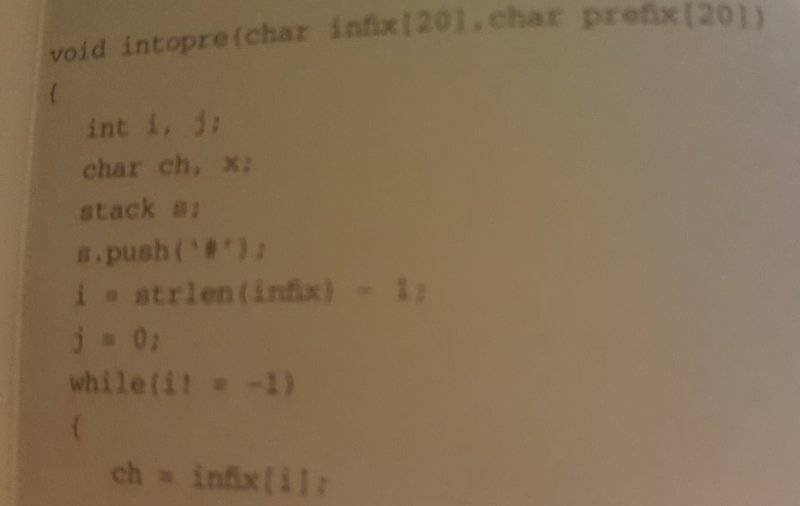

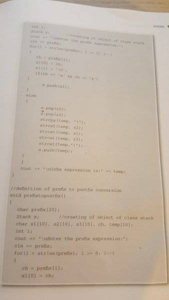

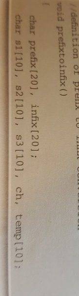

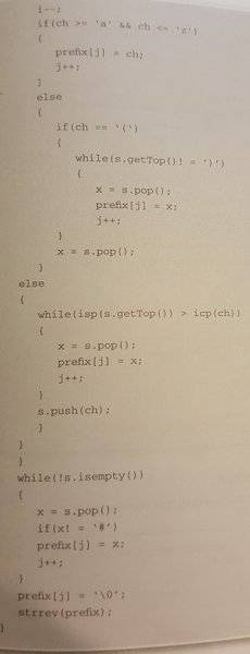

I found a different algo in my book,
Sorry for the odd format, but this one seems more similar to code that my professor wants to produce. The input would be a infix question like cin>> infix

@Mark44 , I'm confused on the void intopre part. The example uses char while my professor wants us to use strings...

Kingyou123 said:
I found a different algo in my book,View attachment 106856 View attachment 106855
No, the code for intopre doesn't use char for its parameters. Its parameters are char arrays. There is no type named string in C, but there is a template class in C++ named string. Is that what you are saying?

Code:
string infixToPrefix(string expression)
{   //FINISH ME!
    stack<char> S; //holds operators
    stack<char>output; //display like in class
    string prefix = "";
    char ch , x;
    int i, j;
    i = expression.length() - 1;
    while (i!= -1)
        ch= infix[i];
        i--;
        if (ch > = 'a' && ch <= 'z')
            prefix[j] = ch;
            j++;
        else
            if (ch == '(')
                while (S.getTop()!= ')')
                    x = S.pop();
                    prefix[j] = x;
                    j++;
                x = S.pop();
            else
                while (isp(S.getTop()) > icp(ch))
                    x S.pop();
                    prefix[j] = x;
                    j++;
                s.push(ch);
    while (!S.isempty())
        x = S.pop();
        if (x!= '#')
            prefix[j] = x;
        j++;
    prefix[j] = '\0';
    reverse(prefix.begin(), prefix.end());
    return prefix;
I have done this so far, is there a way to get the top part of the stack without creating a get top function?
