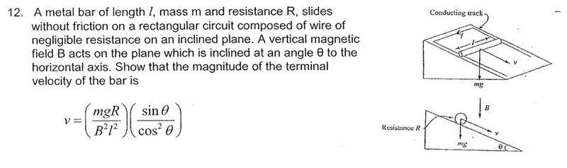

Insane Electromagnetic Induction Question. Challenge your brains! :D
F=BIL, F=mg
There is a B field acting on the rod so we resolve that.
I tried to resolve the other force vectors according to:
1. Force acting on rod by gravity
2. Force acting on rod by electromagnetic (F= BIL)
but I can't seem to see the link between velocity and force??
Thanks in advance guys :)
the electric force on wire is
[tex]\frac{Blvcos\theta}{R}.Blcos\theta=\frac{(Blcos\theta)^2}{R}v[/tex]
This force acts in opposite direction of the gravitational force.
Thanks, I got it :)
