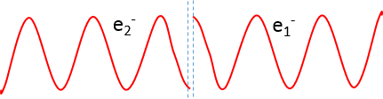

The answer I came up with is to do with my ignorant reading of the Pauli Exclusion principle and the spin statistics theorem. The idea is that electrons in the same orbital are always 180 degrees out of phase. Which seems to be sort of what the spin statistics theorem says? (you probably won't like that, but I feel I should do my best to represent this interpretation) When one is cresting, the other is in the opposite trough, so to speak. That way they can coexist, I guess, as long as they are not occupying the same state. Notice that there is no room for more than two waves like this, if you try to fit a third one in, then the waves are intermingling, so that they occupy the same state, not allowed. Consistent with the exclusion principle.
244116
Quantum state then, would be defined by timing? Not sure how to say it. The waves are 180 degrees out of phase, but there are also in perfect sync. In this interpretation (If you can call it that) being in sync makes them part of the same object.
Then an atom, with all its protons, neutrons and electrons, if all of them are in sync, the whole atom is one object. If you treat it gently, it reacts as one object. Same for molecules that are treated gently. So you can send molecules gently through a double slit and get a diffraction pattern.
Timing also explains entanglement in this interpretation (if I can call it that) two electrons in perfect sync are entangled, thus become part of the same object. It seems intuitively reasonable that measurement of one can affect the other with all I am saying.
No, that's not correct. They have opposite spins, but this has nothing whatever to do with the phase of their spatial wave functions, which is what the orbitals give you the shape of. The spins of the electrons are separate degrees of freedom from the configuration space (position-momentum) degrees of freedom.
