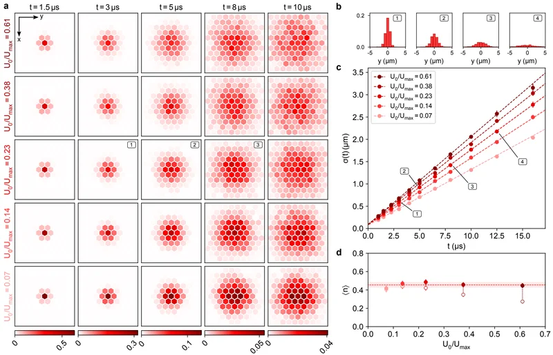

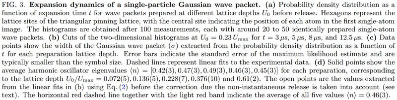

Yes, the spreading of single-atom wave packets has been observed experimentally and agrees with theory:
In-situ Imaging of a Single-Atom Wave Packet in Continuous Space

Nature doesn't really choose a Gaussian, per se, but experimentalists, as in the paper @renormalize shared, can set things up to ensure that wavefunction is a Gaussian. If you can get particles into the ground state of a harmonic potential and shut off the potential, then you'll know you started with a Gaussian. That's what is described in the paper. Ultimately, it all comes down to a state preparation procedure.
