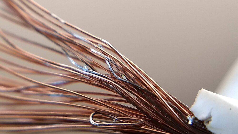

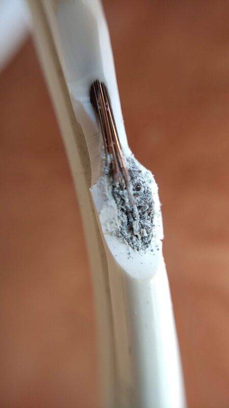

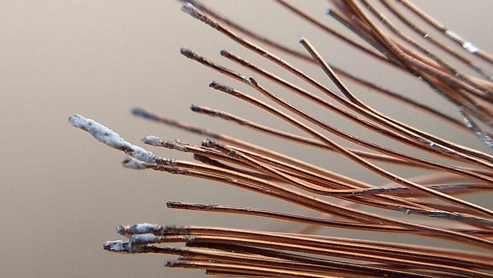

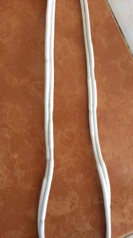

@tech99 @Tom.G jokes apart, it's not a matter of conduit size. The PVC insulation on the affected wire was INTACT, as I explained in the opening post. It was just a little "bulging" (swelling) at the spots where the copper got pulverized, but wasn't chewed nor broken before I cut it longitudinally to extract the powder.
Majorana said:
Dear all,
thank you so much for all your contributions.
Going backwards:
@Klystron the floor is not a raised floor with plenum, ducts etc. It's an ordinary, old concrete floor, with plastic tubing for electrical wires embedded in it.
@Guineafowl I'm really unable to see your point in sticking with the aluminium idea, despite all the contrary evidence. Until now, I did not want to mention the fact that I am an experienced electronics designer, that I also designed electronics for military aircraft in service nowadays, and that I have handled, stripped and soldered electrical wires of any sort for almost 50 years now, but now I feel obliged. Any scientist knows that trying to shape evidences in order to match a theory leads to faulty results. I know very well that an aluminium wire would explain this phenomenon much easily than a copper wire, but unfortunately this is not the case. I might borrow a camera with macro lens just to post a picture of the cross-section of the copper strands, but I feel that this thing has gone too far.
@anorlunda yes, it's perfectly possible, and in addition the colour of that powder was not perfectly homogeneous. The next step I wish to take would be to have that powder analyzed. It's not so easy to find a lab willing to do the job for a private citizen. In case I find one, I would certainly post the results here, be sure of that.
@Borek as I mentioned a couple of times in my above posts, the two external sections of the cable that did not lie under the floor (they went vertically from the floor to a junction box on the wall on one side, and to the loudspeaker on the other side) are completely normal and unaffected, as well as a length of excess cable left over after installation and stored in a drawer in the same office.
Something similar happened to me with a cable, It turned into grey power, but it hadn't been in use for a long time. The cable remained in a house that is on the beach, so there is high humidity and salinity that accelerate corrosion. In my case it was as @Guineafowl mentioned. The sections that still had wires, at first sight seemed like copper, however, when I scratched them, the silver color came out. Perhaps the humidity and salinity affected the alloy of copper with aluminum.

Carol, you got it! 👍 My wires look exactly the same way (although corrosion was perhaps more "complete" in my case, but I guess it's just a question of time...)
In my case, the environment is completely different from that of a beach house: large city, hundreds of kilometers from the sea, no construction works in the vicinity. But yes, the climate is generally damp, although not saline.
