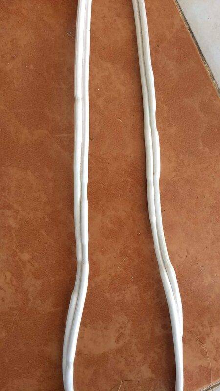

Insulated copper wire turned into gray powder
The discussion centers around the phenomenon of insulated copper wires, specifically a red wire from a loudspeaker cable, turning into gray powder after 18 months of use. Participants explore potential causes for this deterioration, including material composition, environmental factors, and chemical reactions, while noting that the black wire remains unaffected.
  • One participant suggests the wires may be copper-coated aluminum, proposing that a reaction between the red PVC coating and aluminum could be responsible.
  • Another participant raises the possibility of oxidation occurring due to high humidity, questioning the manufacturing date of the cable.
  • Some participants assert that the conductors are indeed bare copper, with one emphasizing their expertise in distinguishing between copper and aluminum.
  • Corrosion due to trapped vapor is discussed, with a focus on how it may be concentrated at colder points in the cable.
  • A participant hypothesizes that impurities in the red PVC insulation could have led to chemical damage, suggesting that swelling indicates a conversion of copper to a higher volume compound.
  • There is mention of a potential DC component in the audio signal exacerbating electrochemical corrosion.
  • One participant proposes that a chemical analysis of the gray powder might provide insights into the nature of the contaminant causing the deterioration.
Participants express differing views on the material composition of the wire and the causes of its degradation. There is no consensus on the exact reason for the transformation of the copper into powder, with multiple competing hypotheses presented.
Participants note that the cable was purchased from a reputable store and was not old at the time of installation. The discussion highlights the uncertainty surrounding the conditions that led to the observed deterioration, including the role of environmental factors and material impurities.

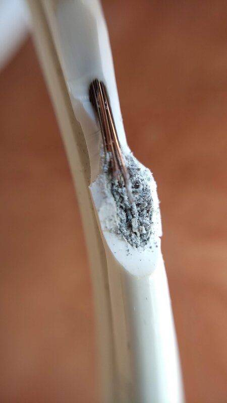

  • #31
anorlunda said:
However if we uncritically accept the facts as presented in this thread, exactly the damaged length of wire (no more, no less) was installed under the floor and not in the walls.
I don't believe that to be true, simply based on it being too coincidental. I suggest that the cable was in pretty much undamaged condition when installed, and that copper corrosion largely occurred subsequent to installation. Visual examination of the copper core in the red cable over the length where bulging is not evident should confirm/deny my hypothesis.

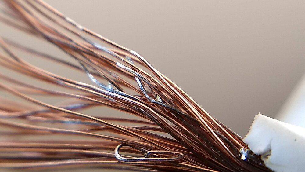

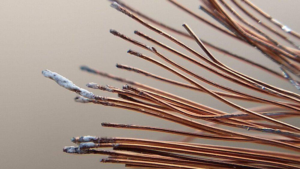

I just found a lab to analyze the mystery powder! :cool: They would be available to check a sample in a week, next monday to be precise. Results should follow within two or three days. Stay tuned! ;-)
  • #39
Good day folks,
the analysis took considerably longer than I had expected, and the results are not as exhaustive as I hoped: the problem was the VERY small amount of powder that I was able to collect. Once I had removed all the pieces of residual solid copper (partially dissolved wire strands) from the powder, the yeld was perhaps less than 50 mg worth of gray powder. ANYWAY, the analysis reported that it was constituted of copper salts only. No trace of any other metals (aluminium...) was found.
Before and after the analysis, I had a bit of brainstorming with a chemical engineer, whose multi-decade experience with the chemistry of metals came in just handy. After a lenghty explanation about the "mystery cable", details of the installation, the bubbles etc etc, he theorized that a number of notable coincidences may have concurred to the degradation of metallic copper into a gray powder.
He supposed that, if the PVC insulation had some (almost)invisible cracks that put the copper strands in contact with the environment; if the environment was not only relatively moist [RH over here lies in the range 60%-85% most of the time] but also alkaline (the floor is made of concrete, so that's quite probable), and if the air was contaminated by certain elements that I can't remember right now (this is a 3.5M inhabitants city located in a very large depression with little natural ventilation, so smog and haze are almost constantly present), then the copper may have reacted with the oxygen and water in the air, and due to the alkaline pH and the other contaminants the outcome was not just the usual greenish-graysh-blackish coat typical of copper, but a complete degradation/disintegration.
It goes without saying that nor him or any of his colleagues had ever seen something like that before...

That sounds like a rational speculation. But it sounds like a case where the explanation will never be established with certainty.
  • #41
Any (practical) way of finding out which salts?
  • #42
None "practical". Because the very small amount of powder in the few "bubbles" left would make further in-depth analysis very hard or impossible at all, AND because (I've been told) the labs out there that perform inorganic chemistry analysis - a tiny minority, since the vast majority are clinical analysis labs - are aimed to testing environmental-protection-related substances, which is not the case here. I guess some University lab could be a good candidate, but I don't have any hooks in there...
