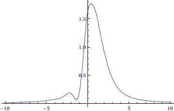

Hello!
I'm trying to calculate this integral:
Integrate [Exp[-I a *y] Exp[I*Sin[y]] Exp[-y*Sign[y]], {y, -Infinity, Infinity}] , where "a" - constant that i'll define later.
So the result of the calculation acсording to Mathematica is the same expression : Exp[-I a *y] Exp[I*Sin[y]] Exp[-y*Sign[y]].
What can i do to calculate my integral without defining my constant "a" and using NIntagrate?
Thank you in advance.
I doubt that Mma returns the integrand - it probably returns an unevaluated integral, no matter what choice you make for the constant a. The integral probably does not have a nice closed form in terms of any common or existing special functions.
Mma doesn't even evaluate the "simpler" integral Exp[I*Sin[y] - y^2].
If you just need to use this result just define the numerical integral (with memoization)
int[a_?NumericQ] := int[a] = NIntegrate[Exp[-I a*y] Exp[I*Sin[y]] Exp[-y*Sign[y]], {y, -Infinity, Infinity}]//Chop
It's a little slow... but you can get a reasonable plot of the integral
Plot[int[x], {x, -10, 10}, PlotPoints -> 15, MaxRecursion -> 3, PlotRange -> All]

Thank you so much for answer!
Not a problem. I hope it was useful.
If you do find a closed form to that integral - don't forget to post it here!
