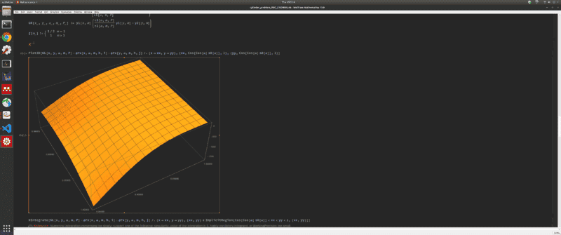

I'm numerically integrating over a Green's function along with a few very odd functions. What I have looks like this
Code:
NIntegrate[-(1/((-1.` + x)^2 (1.` + x)^2 (1.` + y)^2))
     3.9787262092516675`*^14 (3.9999999999999907` +
     x (-14.99999999999903` +
        x (20.00000000000097` - 9.999999999999515` x +
           1.` x^3))) (-1.` + y)^2 (4.` + y) BesselJ[4,
    304.6888201459785` Sqrt[1 - x^2]] BesselJ[4,
    304.6888201459785` Sqrt[1 - y^2]] Cosh[
    310.00637327206255` - 304.6888201459785` x] Cosh[
    310.00637327206255` - 304.6888201459785` y] /. {x -> xx,
   y -> yy}, {xx, yy} \[Element]
  ImplicitRegion[
   Cos[Cos[\[Alpha]] Cos[\[Pi]/180]] < xx < yy < 1, {xx, yy}]]
but Mathematica throws a "numerical integration converging too slowly" error. How would you treat this?

Can you explain the advantage to this approach over what NIntegrate currently does? Also, notice the region with which I am integrating: it's essentially $$\int_{\cos(\cos \pi/180)\sin(\pi/180)}^1\int_{\cos(\cos \pi/180)\sin(\pi/180)}^y f(x,y)\, dxdy$$ which I don't know how to perform numerically since a variable is in the integration limit.
Also, the integrand when plotted over the integration region ##[\cos(\cos \pi/180)\sin(\pi/180),1]\times [\cos(\cos \pi/180)\sin(\pi/180),1]## looks very well behaved as you can see:

Wow, thank you both for the replies! Never used MCI before, but I'm checking it out. Very cool idea, and nice clear python script you wrote.
pbuk: I copy-pasted Mathematica output without really reading it. I didn't want to mess anything up by rounding so I thought this was easier. Those numbers stem from previous numerical calculations. And the cosine terms you ask about are a typo on my part: the integration limits in post 3 should read from ##[\sin\alpha,1]\times[\sin\alpha,1]##
