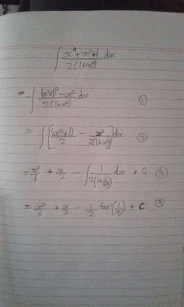

Integrate: [(x^4+x^2+1)/2(1+x^2)]dx
[/B]
Integral of x^n=x^(n+1)/(n+1)
Integral of 1/(1+x^2)=arctanx
I have attached my solution.All the steps seem to be correct,but the answer isn't matching,don't know why.
Your integration from lines 3 to 4 is not correct:
[tex] \int \frac{1}{1 + x^{-2}} \mathrm{d} x \neq \tan^{-1} \left(\frac{1}{x}\right).[/tex]
My suggestion is to instead split the original expression as
[tex] \frac{x^4 + x^2 + 1}{2(1 + x^{2})} = \frac{x^4 + x^2}{2(1 + x^{2})} + \frac{1}{2(1 + x^{2})}.[/tex]

Oops,why didn't I think of that?Thanks.

Yep,sorry.
