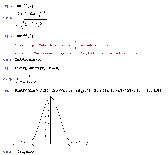

For m=0:
But actually this is what I tried first: Just plugging in the 0 gave 1. But then I recalled my Mathematic courses: You must not do it this way. If you encounter any [math]\infty[/math] or 0 in the denominator, you better should calculate limits...
So I did this. Can you tell me why Mathematica gives me a different result? I thought when taking the limit the result should be the same; and if it is not, there is a problem with the direct way...
Additionally I plotted the function in Mathematica (without the exponential because this will be 1 anway). As you can see the value at 0 is not 1 but 1.37 ... the same stuff as Mathematica gave symbolically...
I have attached a screenshot.

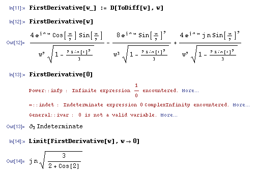

Now to m=1: Indeed, when I use Wolfram Alpha there is a huge amount of expressions but when I just plug in zero, there seems to stay just n.
Now I tried also something which I did not yesterday: I did the second derivative in Mathematica. Again, just setting [tex]\omega=0[/tex] gives an error. But using the limit, I get
[tex] \lim_{\omega \rightarrow 0} \frac{\partial}{\partial\omega} f(\omega) = j n \sqrt{\frac{3}{2+\cos(2)}}[/tex]
The j cancels out, so there stays only the n. But there is again the root which should be 1 ...
Who is right? And why? Does really Mathematica do a mistake when calculating a limit?

Haven't looked at the whole problem, but it seems the argument of sine in the first screen is "1" instead of "w/2". If so, Mathematica is right.
Moreover, in the plot command, there's "Sin[w/w]" instead of "Sin[w/2]".
Yessss! That was it! Thank you very much! Plot is not @1.
