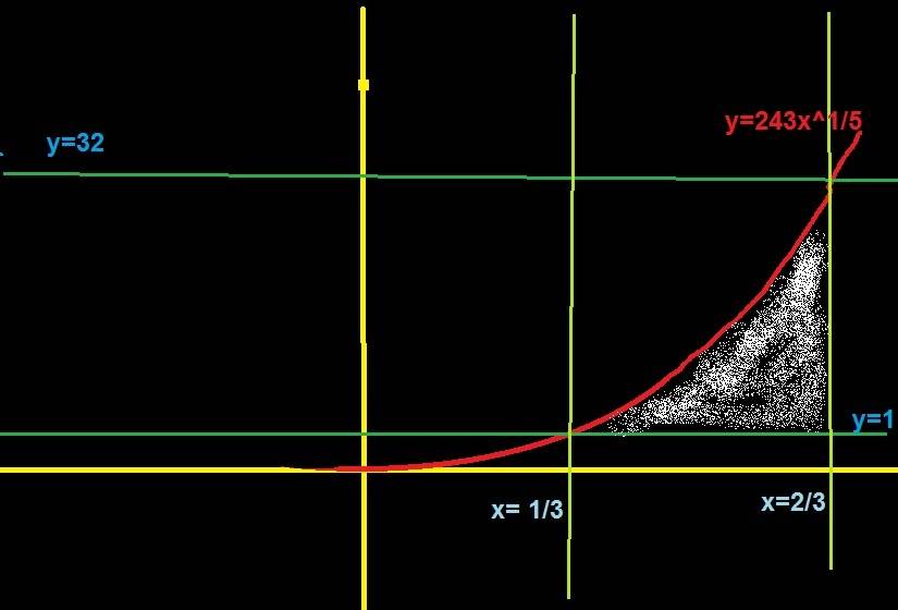

Hey
for question like this I like to draw the curve
[tex]y = 243x^{5}[/tex]
[tex]y = 1[/tex]
[tex]y = 32[/tex]
I find the point of intersection between y=1 and [tex]y = 243x^5[/tex]
[tex]1 = 243 x^5 \Rightarrow x = \sqrt[5]{\frac{1}{243}} = \frac{1}{3}[/tex]
and between y =32 with [tex]y = 243x^5[/tex]
[tex]32 = 243 x^5 \Rightarrow x = \sqrt[5]{\frac{32}{243}} = \frac{2}{3}[/tex]
and the area with the white color
[tex]A = \int_{\frac{1}{3}}^{\frac{2}{3}} 243x^5 - 1 dx = \frac{243x^6}{6} - x \mid_{\frac{1}{3}}^{\frac{2}{3}}=[/tex][tex]\frac{243(2)^6}{3^6(6)} - \frac{2}{3} - \left( \frac{243}{3^6(6)} - \frac{1}{3} \right) = \\ \frac{64}{18} - \frac{2}{3} - \left( \frac{1}{18} - \frac{1}{3}\right)\\ = \frac{63}{18} - \frac{6}{18} = \frac{57}{18}[/tex]
but my answer is not like yours lol

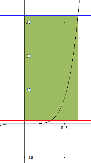

1. If $y = 32$ then $x = \frac23$.
2. The area you are looking for must be inside a rectangle (coloured green) with the length 31 and the width $\frac23$. (see attachment)
3. This rectangle has an area of $\frac{62}3 \approx 20.67$.
So the given solution must be wrong.
Instructive and encouraging.
Thank you,
D'Abs
