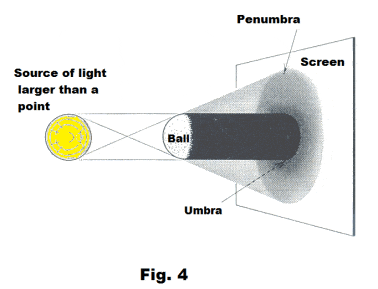

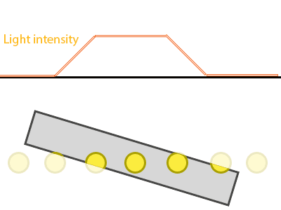

One factor (though likely not the only factor) is that the sun is not a point-like light source. As the panel moves into and out of position, a changing fraction of its disc is not reflecting directly to you.
It is the same effect that causes the penumbra of an eclipse.
Like so:
Thank you so much!

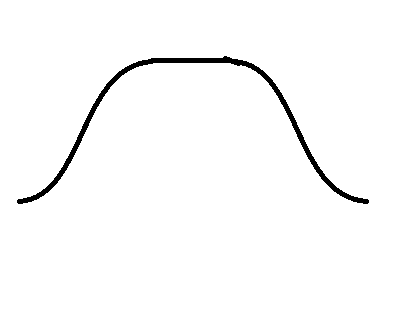

I understand it perfectly now. I had some ideas when i was looking at the solar eclipse dark spots on the Earth surface, but i wasn't able to drive it to the end. Thank you so much. I don't want to bi nagging and annoying and i hope you will excuse. Light intensity graph is more like this right?
Thank you again! I would be smashing my head for a while if you wouldn't help.
Yes. PhotoShop doesn't do curved lines easily. :wink:

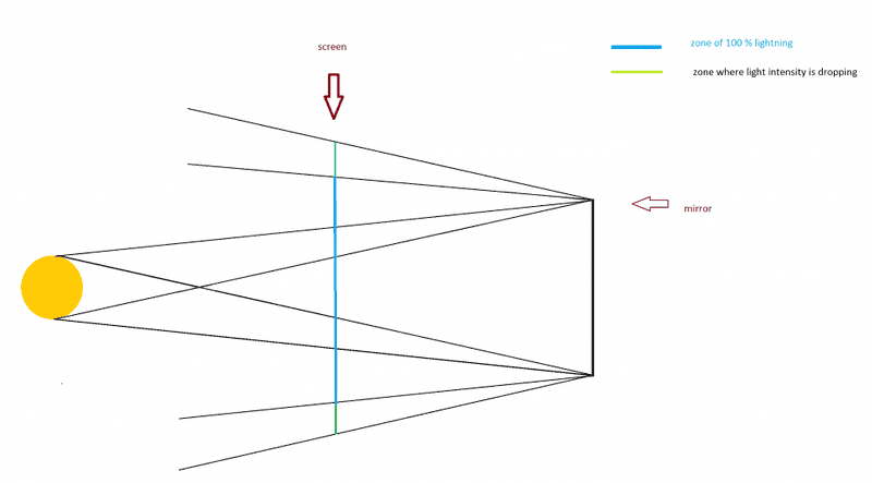

Hello Dave, i hope you will be reading this. I just wanted to aks you if this diagram is correct when explaining whole situation. Do you think there should be any corrections?
Thank you :)
