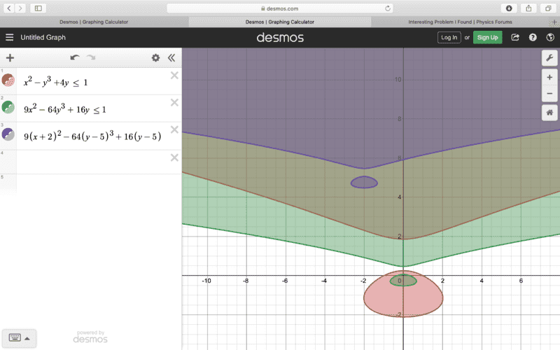

Let $$ A = { (x,y) : x^2 -y^3 +4y \leq 1}$$ . Now let B be the set obtained asymmetrically scaling A by a factor of 3 in the x-direction, and by a factor of 4 in the y-direction, then translating the scale set by the vector <-2,5>. Use a graphing tool to show A and B.
$$ h(x,y) = x^2 -y^3 +4y \leq 1$$
What does asymmetrically scaling mean?
I am unsure of how to do this problem. I am thinking $$ h(3x,4y) = 9x^2 \ - \ 64y^3 \ + \ 16y \leq 1$$, which gives us the scaling we want in the x-direction and y-direction.
Now, for the translation of points of A by the vector <-2, 5>. I am unsure.
I am a bit embarrassed posting this. It appears that this problem is just a linear transformation problem.
This problem is for fun, and not a hw exercise.
I have attached a graph of the set A.
Here we go!

Just as a guess, I think it refers to the different scaling in the x and y directions.
Amplifying the coefficients reduces the x and y values satisfying the equation. That will shrink the area.
For the translation, you want the bit of the graph that was at x=0 to be at x=-2 now. What do you need to substitute for x in the equation ?

So I am thinking of replacing x with x+2 and y with y - 5 into the function ## h(3x, 4y) \ = \ 9x^2 \ - \ 64y^3 \ + \ 16y \leq 1 ##.
Let ##k(x,y) = h(3x, 4y) \ = \ 9x^2 \ - \ 64y^3 \ + \ 16y \leq 1 ##.
So ##k(x+2,y-5) = \ 9(x+2)^2 \ - \ 64(y-5)^3 \ + \ 16(y-5) \leq 1 ##.
I uploaded an image of graph using Desmos. The red graph is the initial set, green graph is the scaled set, and the purple graph is the translated set. Is this correct?

You do not seem to have understood the first paragraph in my post #3. Looks to me like you have scaled it by 1/4 in the y direction.
Thanks for the reply. Yes, I reread your post #3, and it still is not clear to me.
Since I scaled the set by 1/4 in the y-direction. I am thinking that instead of plugging in 4y into ## h(x,y) = x^2 \ - \ y^3 \ + 4y \ \leq 1 ## , we plug ## \frac {y} {4} ## . Otherwise, was the scaling in the x-direction, and translation ok?
Obviously the same principle applies in the x direction. To broaden the set by a factor of 3 you must replace x by x/3.
You got the principle right in the translation, though: to move it left by 2 you replace x with x+2, not x-2.
