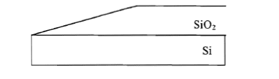

In order to decide the thickness of a SiO2 layer(n=1.5) on Si, a wedge is prepared as shown in the picture. A total of 7 DARK fringes was observed, when light of wavelength 589nm shines prependicularly on the wedge. It is known that light reflected from the Si/SiO2 surface would have a phase change of π rad.
( I don't know why the image cannot appear after posting, it does appear in edit mode. Here is the link:
http://s3.postimg.org/cbvntdri9/physexam1q3.png)
i) Determine whether the fringe at the thinner end of the SiO2 wedge is bright or dark. Explain briefly. (2M)
ii) Calculate the thickness of the SiO2 layer. (3M)
iii) If the setup is illuminated by a light of shorter wavelength, what chages would you expect for the number of fringes observed? Explain briefly. (2M)
iv) If the setup is placed in water(n=1.33), what changes would you expect for the number of fringes observed? Explain your answer briefly. (2M)

i) Dark? Just guess. What should I consider?
ii) 2nt = mλ, m = 7
2(1.5)t = 7*(589*10^-9)
t = 1.96*10^-7m
iii) Just guess: Because 2nt = mλ, where 2nt is a constant. When λ decreases, m has to be increased. So the number of fringes observed increases.
iv) Same? But it doesn't seem correct...

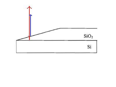

You observe reflection. Interference happens between the directly reflected ray (blue) and the one, entering into the layer and reflected back from the SiO2-Si interface (red)
For constructive interference, the phase difference between the blue and red rays should be integer times 2pi. What is the phase change of the directly reflected light?

You see a dark strip on the wedge where the thickness of SiO2 corresponds to the condition of destructive interference.The thickness depends on x, the horizontal distance from the edge and the angle of the incline - how?

tanθ=thickness/horizontal distance,
thickness=horizontal distance*tanθ?

Yes. What should be the thickness at the first dark strip?

The wavelength 589 nm is given for air. You have to multiply the thickness by the refractive index. And the ray travels the thickness twice, once forward, then backward.

Good. You see the first dark fringe where the thickness is 589/6 nm. Where do you see the seventh one?
