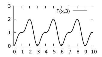

Define a continuous function $$F(x;n)$$ that interpolates points (x, x mod n) for a given integer n and all integer x. For example $$F(x;2)=\frac{1}{2}-\frac{1}{2}\cos\left(\pi x\right)$$ interpolates all points (x, x mod 2) when x is an integer. Similarly $$F(x;3)$$ should interpolate points (0,0), (1,1), (2,2), (3,0), (4,1), and so on and so forth.

As a first shot, here's $F(x;3) = 1 - \cos\left(\frac{2\pi x}3\right) - \frac1{\sqrt3}\sin\left(\frac{2\pi x}3\right)$:

Nice attempt. Below is my output for F(x;3).

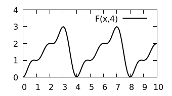

For $n=4$ I'm getting $F(x;4) = \frac32 - \cos\bigl(\frac{\pi x}2\bigr) - \sin\bigl(\frac{\pi x}2\bigr) - \frac12\cos(\pi x)$. I don't yet see what the general formula should be, but it seems that the constant term in $F(x;n)$ must be $\frac{n-1}2$.

Indeed, I meant smooth function and your finding of constant term matches with mine. So, high five. Below is my output for F(x;4). I guess it will help to get the idea that there is a pattern.
