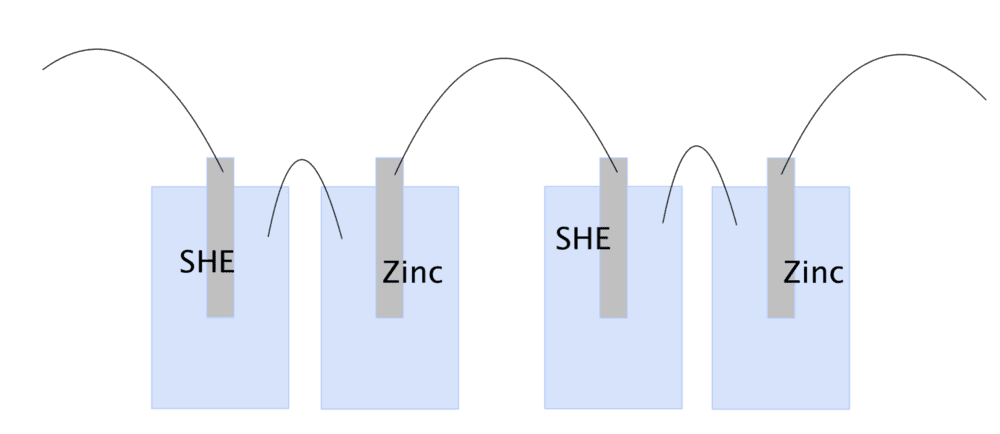

If I set up two half cells in series, as such:
then which SHE is this value referring to? It can't be both, since there's 0.76 V between them! Something seems really fishy about this...
Neither. It refers to an isolated single electrode. Connecting them to other electrodes affects the potential.
Consider e.g. a small conducting sphere of radius r with a charge of +Q. In isolation, the potential at the surface is kQ/r. Now consider arranging 4 spheres in a line, with a distance d between each, as follows:
+Q...-Q...+Q...-Q
Will the two positive spheres have the same potential as each other, or as the isolated sphere?
etotheipi said:
I am assuming for each individual half cell, the reference is just above the surface of the solution for each
I think that is right - each individual electrode has its own reference. If you have a common reference (e.g. the RH Zn electrode) the two SHE electrodes will have different potentials.
