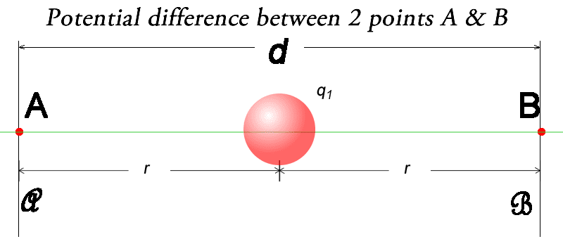

See attached picture. q1 is at equal distance from A or B.
k = coulomb's constant
VA = (k q1 / r)
VB = (k q1 / r)
VAB = VA - VB = 0 V
It seems that the charge becomes invisible in that case, right?
  • Diagram titled Potential difference between 2 points A & B: a red charged sphere labelled q1 sits midway between points A and B on a horizontal green line, each a distance r from the sphere, with total separation d marked across the top.
The charge is not invisible.
We have (roughly) the same gravitational potential everywhere on the surface of earth. Is Earth invisible? Do you float freely in space?
That's right but its effect on voltage difference is the same as if there was no charge.
Any charge configuration admits equipotential surfaces. The potential difference between any two points on such a surface is zero. Which does not mean there is no charge.
