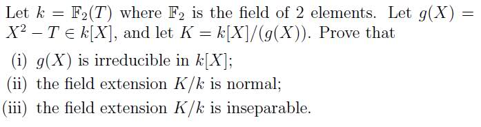

Trying to do i) and iii) on this past exam paper
For part i) I'm pretty stumped
I've said that the possible roots of the polynomial are +- all the factors of T
In particular rt(T) needs to be a factor of T but this can't be possible?
Doesn't sound too good but its the best I've got.
Part iii) I know this means that every element in K is seperable over k, i.e that the minimal polynomials of elements in K are seperable, where they have no repeated roots.
Not sure how to apply this though..
Maybe K = k(rt(T))
so the minimal polynomial of K is X^2 - T which has repeated root rt(T) so it is inseperable?

micaele said:
For part i:
Because this is a finite field, you must show that the polynomial g(X) has no roots in k. Because k is a finite field of 2 elements, you can just try plugging in 0 and 1 because k = {0,1}.
So g(X) is irreducible if and only if 0^2-T is not equal to zero and 1^2-T is not equal to zero. Since T is an extended element onto k, I think we can safely draw our conclusion. What do you think?
isn't k = {0, 1, T, 1+T} since k = {a + bT | a, b in {0,1}}
Otherwise I see what you mean. Thanks for the reply
yeah you're completely right and i noticed my mistake right after i posted that. i overlooked the whole extended element thing. my bad.
