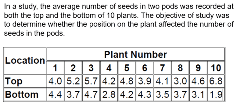

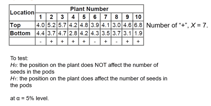

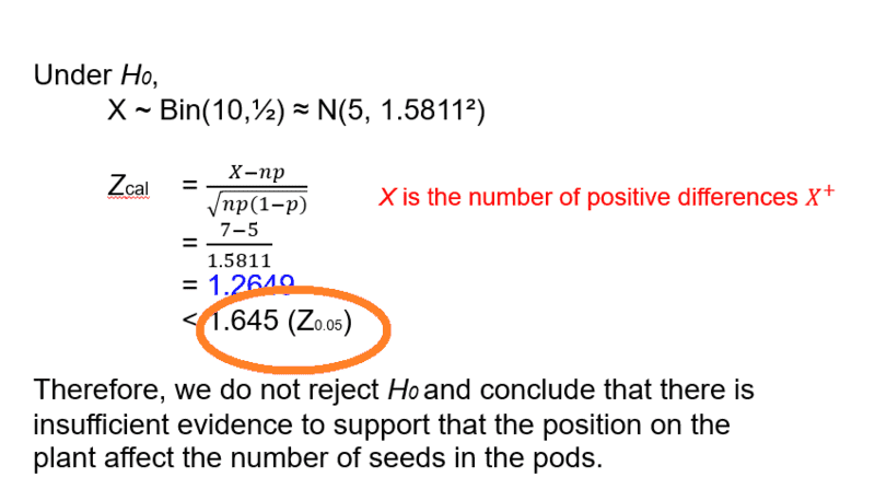

In the photo above ,
H0 = the position of the plant doesn't affect the number of seeds in the pods .
H1 = position of the plant affect the number of seeds in the pods
This is a two -tailed test , am i right ? Referring to the normal distribution table , z α=0.05 = 1.645 , z α/2=0.025 = 1.960 ... In the example , it's clear that the author use one -tailed test . I think it's wrong . He should use z α/2=0.025 = 1.960 , Am i right ? Correct me if i am wrong .

If the author intended you to use a one-tailed test, it's not very clear from the problem description.
then , it's one tail or 2 tailed test ? Based on your opinion ... Because the H1 = position of the plant affect the number of seeds in the pods , so i assume it's 2 tailed test
I think you are right. The one tail test would be appropriate for these hypotheses:
H1 = Being on top increases the number of seeds
H0 = Being on top does not increase the number of seeds
The two tail test is appropriate for the stated hypotheses of the book, regarding any difference -- increase or decrease. The Z value of the book is for the 90% two-tail confidence level, (95% on each side). (see the second table, "Critical values", in http://pegasus.cc.ucf.edu/~pepe/Tables )

There are many things wrong with this example.
(1) The data make little sense. How can the number of seeds be 5.2 in the top pod and 3.7 in the bottom pod of the exact same plant? Don't seeds come in integer numbers, 0,1,2,...? How can you have an "average number of seeds" for a single plant? I suppose there could be N1 pods on top and N2 pods on the bottom, with the "averages" being the average number per pod among the N1 top pods, etc. However, in that case, why bother with averages? Just look at the total number of seeds on top and on the bottom. It looks to me like a highly artificial problem using some arbitrary numbers, designed to give the illusion of a real problem. However, YOU are stuck with doing the example, whether it makes sense or not!
(2) How can the seed numbers in the top or bottom, or their difference, be Binomial(10, 0.5)? Here, the '10' looks like the number of plants tested, but the number of seeds in an individual plant will not depend on how many plants we choose to examine. The number of seeds per plant will be determined by the biology of the plant itself, and possibly by environmental factors, etc. Possibly, saying that the number of seeds is random with distribution ##\text{Binom}(N,p)## could be a good approximation, but there is no way to say a priori that ##N=10## and ##p = 1/2##. I guess it is possible that the person setting the problem really meant so say that "observation shows that the probability of seed numbers is approximately binomial with parameters ##N=10## and ##p = 0.5##", but if that is the case, that is the way they should have said it. Otherwise, they are likely to maximize the confusion of the student.
(3) Since the top/bottom numbers are paired (to a single plant), using a paired-sample test (such as a paired-sample t-test) might be appropriate. Certainly for a single plant the top and bottom numbers are dependent, but with careful experimental design or appropriate data-gathering, the numbers between different plants might, possibly, be independent. Even if a paired-sample t-test is not appropriate (because of non-normality of the data), it would make sense to use a non-parametric test for ##H_0: \mu=0## vs ##H_1: \mu \neq 0## for the mean ##\mu## of a sample ##X_1, X_1, \cdots, X_{10}##. Here ##X = \text{top number} - \text{bottom number}##. And, a two-sided test would be the way to go.

Can you help me to confirm again ? I read a several online notes , the alpha used is 0.05 not 0.025(alpha /2) for 2 tailed test ...
1) The test should be a 2 tailed test because the null hypothesis you specified is "doesn't effect". That includes effects of higher or lower -- so 2 tails.
2) You specified a Zc value of 1.645 in the OP. You can see on the "Critical Values" table in the link that the Zc value of 1.645 is the .90 2 sided value.
3) A 2 tail test at 0.90 confidence has 0.05 on each side (tail). So the number you give is for a 90% confidence level.
If you want a 95% confidence, you need to either change the hypothesis to 1 sided "tops have more seeds than the bottoms", or change Zc value to 1.96.
so , your conclusion is by saying at alpha = 0.05 , then the Zc should be Z0.025 = 1.96 , am i right ?
