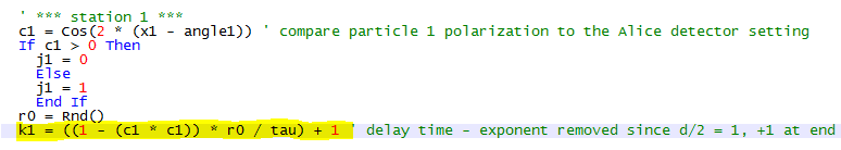

I don't accept the fair sampling argument either, but that doesn't mean an argument here that was characterized as a fair sampling argument here actually was. Some inefficiencies may lead to some slightly distorted data, but experimentally today it's well withing QM constraints. I see no reason to question perfect QM predicted correlations in the ideal case.
I did notice, in my own computer models, that the standard deviations increased greatly at offset maxima. I used a sample group of 10k photons. The standard deviation increase occurred due to low sample size as the expected hits/misses approached 0 or 100%. I was modeling the ideal QM case with exactly known particle numbers and detections, with perfect correlations and ideal detectors. This is likely to vary at least some in less than ideal conditions, but I don't see that refuting, or even seriously questioning, the QM predictions. I'll stick with modeling the ideal QM predictions.
Some interesting points was made in the video wrt rotational invariance (@12:30). I'm not sure how to interpret the anomalies. It looks too consistent in the pdf graph, even across experiments, to simply be variations in standard deviation. Yet the correlation coefficient remain consistent with QM. Weird.
