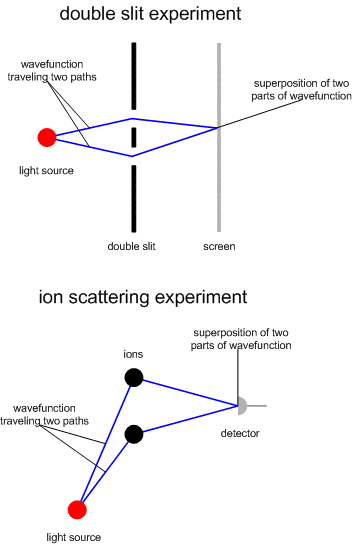

I am not complaining about spacelike separation of ions. The problem is that this experiment fails to demonstrate entanglement between two ions.
Non-local correlation does not have to appear at the moment when ions scatter light.
This correlation can appear later quite locally when light from two ions overlap. And then there is no spooky action at a distance but quite local interference of light.
You can try to extend result of Weihs et al experiment to two ions in a way that if they are entangled it can not be explained by some mysterious communication at light or sub-light speed. The problem is that they don't have to be entangled at all to explain results of this experiment.

Frame Dragger said:
How so?! This seems like it would require some serious citation.
Again, this is a spectacular claim which requires commensurate support.
I am afraid I can not give you citations but let's look at this experiment from QM perspective (no LHV or anything).
We can compare it with double slit experiment:
In interpretation of experiment wave nature of light is completely ignored, insted photons are treated as particles. But if there are two indistinguishable paths for photons treating photons like particles gives wrong result.
Of course it would be nicer if I could give calculations proving that photon interference alone can account for observed result but even without them it's clear that interpretation of experiment is incomplete and can not be considered conclusive.
