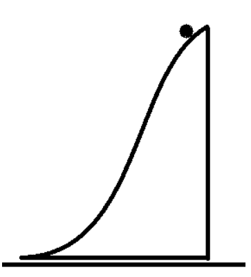

Two identical frictionless slides A and B each of height h and mass M are placed on a horizontal frictionless floor. A small disc C of mass m much less than M is released on the top of the slide A. Find expressions for the speeds eventually acquired by both the slides when interaction of the slides with the bead ceases. (see fig. 1)
Work- energy
Firstly, what I'm about to do is to find the velocity of the mass soon after it doesn't touch the slide A anymore.
using momentum conservation, I got ##0 = mv' + MV'## with ##v'## and ##V'## are the velocity for mass C and slide A respectively immediately after they lost interaction.
Now, I need one more equation. However, I doubt that energy is conserved here because the slide is free to move, and this will cause the contact force between them does Work. But, when I watch the solution video, I'm surprised to know that energy is conserved if we consider slide A.B and mass C is one system. I wonder why...

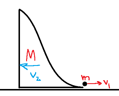

Consider this. When the bead/disc whatever thing is leaving the left slide. What is the velocity of the slide? Hint: momentum conservation. See pic below
##v_2= -m v_1/M##
And what is the relation between h and Vc at its lowest point?
Rikudo said:
Contact force between slide A and mass C.
It said frictionless.
Great,
what is v1 in terms of h then?
Then work out the velocity of the right slide when the bead/disc is on its highest point.
What will the velocity of the right slide be here?

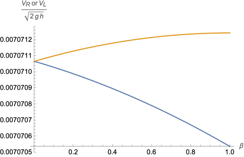

I disagree. It is perfectly clear from the problem statement (##m \ll M##) that the approximation where the bead momentum and energy are neglected is a valid one.
I also disagree that assuming the ball has the same speed as one of the ramps is in any way more accurate. As you mentioned there is an ambiguity in which ramp has the same velocity as the bead. The two cases represent the extreme cases of the range in which the bead velocity can be. However, the bead energy and momentum are still negligible and taking the limit of ##m \to 0## will give the same result. The results all differ by at most a contribution ##\mathcal O(m/M)## so they all work. Neither is necessarily more accurate than the other.
All three approximations have the same degree of approximation. They are valid to corrections of ##\mathcal O(m/M)##.

Unfortunately it is yet another case of guessing intent from subtle detail in the wording.
Assuming the bead matches the velocity of one slide allows two slide speeds to be deduced, the one the bead last encountered and the one it is vainly chasing.
What we cannot do is say which is A and which is B. They will take it in turns to be the faster.
The question says "Find expressions for the speeds". I note that a) it says speeds, not speed, and b) it is not entirely clear that it requires us to identify which slide has which speed.
I'm fairly confident that such a solution would be more accurate than ##\mathcal O(m/M)##. I tried to start with the exact solution then approximate, but I get a 3x3 transition matrix, so it's a bit messy. There's probably an easier way.
