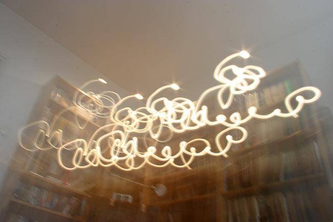

I noticed the algortihm plots motion. This would seem to imply that the camera involved didn't take the picture all at once, but scanned the ccd's to capture the image in a sequential but moderaly fast sequence, the equivalent of a moving shutter. Do all digital cameras work this way (effective moving shutter) or do some of them sample or at least capture light on all the ccd's at once?
I am not sure what you mean, but you can read the motion from the picture taken all at once:
This was shot by manually moving camera with the open shutter.
not sure about the sequential part (don't think so), but each pixel is integrating photon strikes while the shutter is open.
