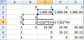

Another way to do the calculation is with generating functions, where P_k is the coefficient of x^k in some polynomial. Here
\prod_{n=1}^{100} (p_nx+(1-p_n)) = \sum_{k=0}^{\infty}P_k x^k
and the product can be calculated by repeated convolution. Seems to give accurate results even with p_n=10^{-6}.

It's called catastrophic cancellation and happens because the formula in post #5 is an alternating series; a similar thing can occur if you evaluate exp(-x) by taylor series.
The polynomial multiplication method in post #16 doesn't have this problem and can be implemented easily in Excel (see attached snapshot).

bpet, thanks for that advice, I'll look into it. In the image you posted, what's in $B$3 and $B$4?
This new version better illustrates the idea (and works for non-constant probabilities):
bpet, thank you so much. That's it. Your formula in post #16 solves the issue of 'loss of significance' (what you called catastrophic cancellation). I've tried it with 40 probabilities, all of them random, and there was no issue of that sort. Then I reversed the order of the probabilities, making EXCEL calculate first the probabilities that it calculated last in the previous run, and compared the 41 (inc. k=0) results from both runs. The sum of differences between all 41 k results was 1 quadrillionth. And a comparison with 65000 randomly generated results in EXCEL showed that the calculated results were perfectly spot on. I'm seriously thankful, to you and winterfors.
