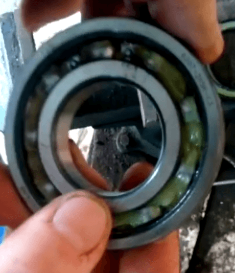

What I mean by a rubber seal is this red thing here.
I thought shields were the metal inserts that some of them have like this one?
You show an integral rubber lip seal that has an internal metal stiffener plate. That is typical of sealed bearings. It would have a part number with suffix -2R or -RR.
IIRC a steel shield would be suffix -Z or -ZZ.

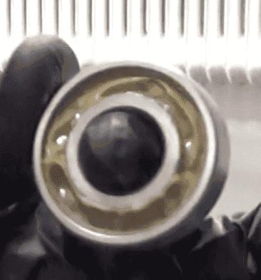

So I've seen videos on YouTube were they open a sealed bearing, brand new, just bought. It looks like there's hardly any grease in there. They all seem to come this way.
They contain sufficient high quality grease. That grease is clean, clear and hard to see. Why do you need to contaminate them to void the warranty ?

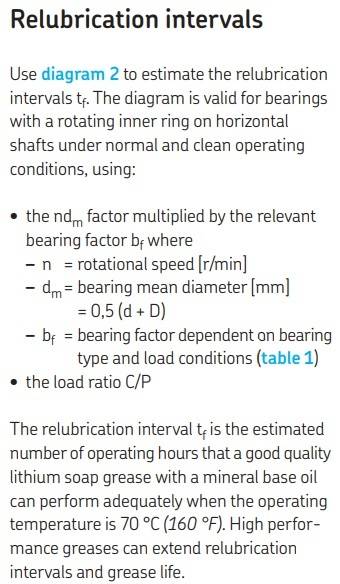

They have a chapter on lubrication starting on page 109. It's well worth the read. That manual has additional lubrication information in some of the chapters about specific types of bearings. The chapter starts with a flow chart for the type (grease or oil) of lubrication:
The next few pages discuss lubrication amount, lubrication intervals, relubrication procedures, and grease types. A partial excerpt:
While the entire bearing manual is an intimidating 1152 pages, the lubrication chapter is only 18 pages, plus a few more pages in the individual bearing chapters. It's written to be understood by people with a good high school education. You should have no trouble understanding it, but do expect to spend some time studying and digesting it.

The result is this on both sides.
While brand new bearings look like this.
I see that once a bearing goes bad and start making noise, the damage is already done and you should replace it. Does the first picture look over greased?
YoshiMoshi said:
I've see this youtube video where they regrease a bearing without removing the seal.
As the picture below indicates, it is easy to force grease through the lip of the seal, by permanently deforming it toward the inside of the bearing.
After that happens, what will prevent dust, air and water from come inside and contaminate the freshly injected grease?
Much lubricant is not equivalent to good lubrication.
There is only a fine film of grease formed among the contacting metal parts that do the work, the rest is there for the free ride, mainly accumulating where the centrifugal effect quickly and permanently places it.
Additives like molybdenum are used to make that film stay put.
If old grease has gone bad due to contamination, thermal cycles and/or heavy oxidation, there is no point in leaving it inside, just to add more on top of it.
The proper procedure is to remove the old grease, to thoroughly clean the metal parts and to apply enough fresh grease to do the job.
Packing grease into the rollers of a conic bearing has been always done by hand, not to by-pass any seal, but to ensure that grease will reach deep inside the cage.
If built-in seals have been damaged or are worn, chances are that it is too late to save the metal parts.
If it is not, removing those old seals, cleaning and relubricating, seems to be better than injecting new grease and leaving the old one inside.
If no better option exists, you could re-install the old seals in place, but knowing that cleaning and lubrication will need to be done frequently after that point.
