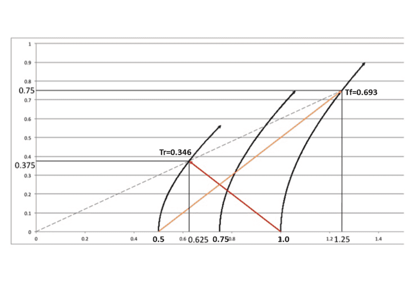

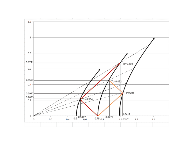

However, the radar distance is not the same. Consider three ships, rear center and front, with equal proper distance between rear and center as between center and front. The ships begin at rest, then accelerate Born rigidly. Flashes of light sent simultaneously from the center toward the front and rear ships reflect off of those ships and return to the center. The forward flash returns before the rearward flash. This is true even though the proper distance between rear and center remains the same as the proper distance between center and front (and despite the fact that the rest distances and ruler distances remain the same also).
So, question 1: what is this radar distance? When we discussed the issue in the earlier thread, posters used examples of curves (such as the distance along a curve from one city to another along the surface of the earth). However, this cannot explain the radar distance here for two reasons. First, SR does not used curved spacetime; SR uses flat spacetime.
Second, the curved line along the surface of the Earth is the ruler distance between the cities. If you lay a series of rulers between the cities you will measure the longer curved distance (rather than the shorter straight line distance that you would get in a tunnel bored straight between the cities underground). But we have confirmed that the ruler distance between center and rear remains the same as the ruler distance between center and front, yet the forward light flash returns to the center before the rearward one does.
Question 2: is it clear what the coordinate distance is between rear and center (and between front and center)? The lattice of rods should remain unchanged in the Born rigid acceleration, and so the distances as measured by the lattice rods should remain the same. In order to ensure simultaneous measurements you have to adjust the clock rates so that each clock ticks at the same rate (choosing a single clock for the Rindler coordinate time rate). But, that does not seem to be enough. The Einstein method of synchronizing the clocks as WannabeNewton describes above depends on radar signals, and so there seems to be a circularity. You need to use radar to synchronize the clocks, but the radar distance is different from the ruler, rest and proper distance.
It is conceptually easier in GR, where I understand that the ruler distance between concentric rings around a black hole is longer than the difference in radii calculated using Euclidean geometry, due to curved spacetime.
Indeed this is true in general and it is precisely due to the reason you stated: if we imagine a rod that is accelerated in a Born rigid fashion from back to front then the closer to the front we get the harder the constituent particles have to accelerate in order to maintain Born rigidity; relative to a background global inertial frame this means that the particles closer to the front of the rod have greater instantaneous velocities than do the particles closer to the back of the rod. However note that radar distance agrees with ruler distance if the constituent particles we are using for measurement are infinitesimally close to one another.
Could you rephrase this question? I'm not sure if you're looking for some explicit calculation of radar distance, a conceptual explanation of radar distance, or something else entirely.
Einstein synchronization doesn't work for a rigid coordinate lattice carried by a uniformly accelerating observer. If a clock in the lattice is Einstein synchronized with the local clock of the observer at some initial local time then the clocks will become desynchronized immediately after. Because Einstein synchronization fails to be consistent for the rigid coordinate lattice carried by this observer, in the sense that initially synchronized clocks become desynchronized soon after, we cannot use Einstein synchronization to define simultaneity for this observer because a simultaneity convention derivative of a synchronization convention requires the synchronization convention to be consistent.
This is why radar distance doesn't agree to all orders with ruler distance for a uniformly accelerating observer: ruler distance automatically takes into account the clock desynchronization since ruler distance is calculated using the geometrical definition of simultaneity whereas radar distance relies on local and distant clocks being Einstein synchronized hence if we have the uniformly accelerating observer use radar distance we are assuming that simultaneous events have the same clock readings which will give us over-estimates and under-estimates of the ruler distance.
However for events infinitesimally close to events on the world line of the uniformly accelerating observer we will find that ruler distance and radar distance agree and this is because the clock desynchronization factor is negligible for clocks in the observer's rigid coordinate lattice that are infinitesimally close to the observer's own clock.
