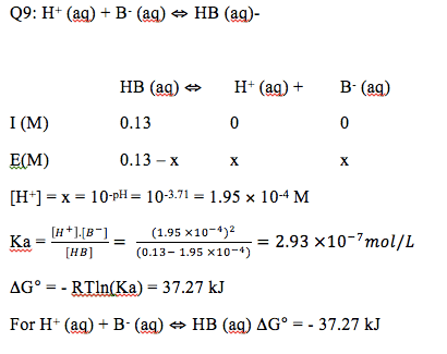

Hello Forum!
I have this review package for my final full of weird mistakes. Problem is that it is hard for me to know if the solutions are right or not:
Could you please look at this problem I attached?
They bizarrely switch from HA to HB. Is that just a typo?
Then, the sign of DG° seems to be wrong! We are looking at the forward reaction, ie it is positive!
I have my final very soon. Any help is appreciated!
  • Handwritten-style ICE table for H+ (aq) + B- (aq) ⇌ HB (aq) with HB at 0.13 M, then 0.13 - x, and H+ and B- at 0, then x, with [H+] = x = 1.95 × 10^-4 M and Ka = 2.93 × 10^-7 mol/L, ΔG° = -37.27 kJ.
  • Typed question: At 25°C a 0.13 M solution of an unknown weak acid, HA has a pH of 3.71. What is ΔG° for H+ (aq) + B- (aq) ⇌ HB (aq)
Where is HA? I do not see it in your attached picture.
I attached two pictures, one is really tiny. Sorry about that.
The HA is a typo. The work backs it up. Your teacher means HB.
Also what do you think the sign on delta G standard should be and why?

It looks like a typo in the problem statement.
Chet
Hmm.. I may have been mistaken. Tell me if I make sense:
So we use Ka (dissociation of HA). Plug that into -RTln(Q)=DG°.
Now, I must reverse the sign because I'm looking at the REVERSE process.
In the end, I get a negative result, which confirms my teacher's answer!
I would say that because your teacher uses double headed arrows, he's referring to an equilibrium, and therefore delta G should be 0. But this isn't relevant because your teacher refers to delta G standard.
Qube said:
I would say that because your teacher uses double headed arrows, he's referring to an equilibrium, and therefore delta G standard should be 0.
This is not correct. ΔG should be zero, not ΔG standard.

Good point! I'll fix it.
