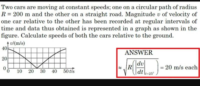

Two cars are moving at constant speed one on a circular track and other on horizontal path. Radius of circular track is 200m. The magnitude of relative velocity is graphed as follows. Find their speeds
$$v_{rel}=v_A-v_B$$
In the question I assumed the velocity of the circular object to be :
$$\vec v_A= v cos( \phi + \omega t) \hat i + v sin(\phi + \omega t) \hat j$$
where $$\omega = \frac{v}{R}$$
Velocity of the other particle is
$$\vec v_B = v \hat i$$
Now magnitude of relative velocity comes out on evaluation to be
$$v_{rel} = \sqrt {2v^2(1-cos(\phi+\omega t)}$$
On further solving, by using
##v_{25}=0## and ##v_{0}=v_{50}##
I couldn't solve further and my whatever little solving I did gave incorrect answers.
So, Is my method correct? If yes then how do I proceed further?
I noticed a second method that simply took relative velocity to be maximum when both were moving in opposite directions and since that value was 40 the value of individual speeds must be 20. I could consider it a correct method if I let the fact that the graph doesn't touch 40 slide. But that leaves another problem ##2 \pi R= 2×200× \pi= 20×50## which is not correct.
Please help. Thank you
This is correct. Technically, that is a transcendental equation, so you'll need some numerical method to solve it, approximately.

It's not entirely clear to me how you are supposed to tackle this. It looks like the relative speed is heading for a maximum of ##40 \ m/s##, but the graph is not complete in this respect.
You could simplify things by taking ##t = 0## when the relative velocity is 0.
The graph is fairly crude. I put my best estimate of the numbers into a spreadsheet and checked which value of ##v## gave the closest fit. ##v = 20.1 \ m/s## was the best fit. Round that down to ##20 \ m/s##.
The function ##f(v)## is that function of ##v## you have above. I tried to match that with ##v_r^2##. Trial and error.

The given solution is based on estimating the relative acceleration when their velocities are equal (t=25s). From the graph, it's about ##2m/s^2##. The result follows from ##a=v^2/r##, and the fact that one car is not accelerating.

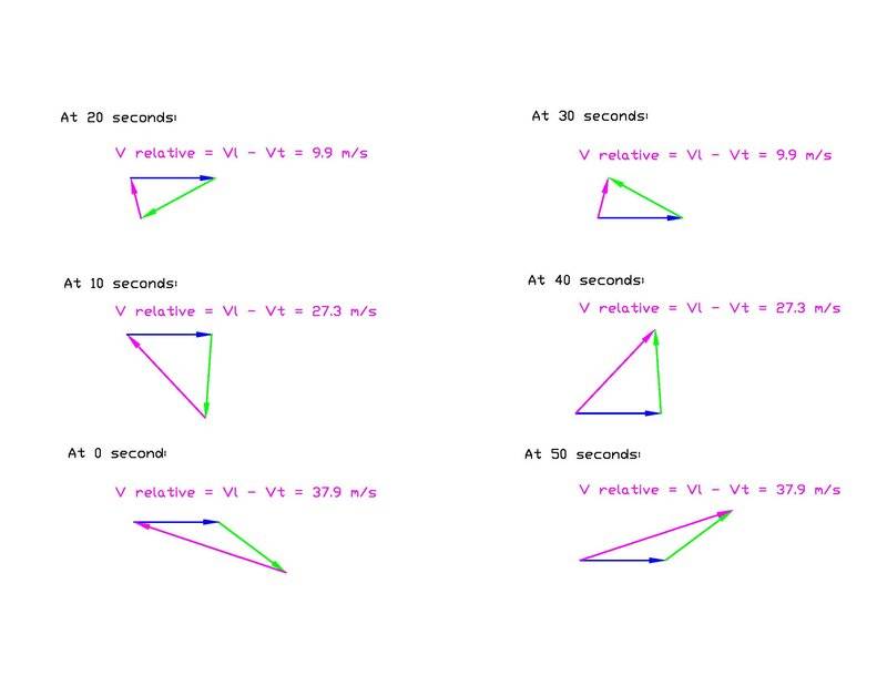

Using the given value of the speed of each car respect to the ground, and assuming certain symmetry of both movements respect to each other, I have put together a graph myself, including summation of the velocity vectors.
I can see in it that the relative velocity does not reach the 40 m/s value because the car on the circular track does not complete a full rotation in the time lapse of 50 seconds.
At the 25 seconds position both car should be moving in the same direction, in order for the differential velocity to be zero, as shown in your graph.
