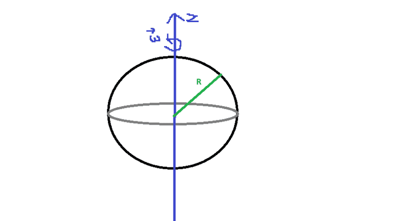

A sphere with radius ##R ## is spatially homogeneously loaded and rotates with constant angular velocity ##\vec{ \omega}## around the ##z ## axis running through the center of the sphere.
Calculate the magnetic moment of the sphere ##\vec m##
##\vec{m}=\frac{1}{2} \int \limits_{V} \vec{r}^{\prime} \times \vec{j}\left(\vec{r}^{\prime}\right) d V, \vec{j}(\vec{r}, t)=\rho(\vec{r}, t) \vec{v}(\vec{r}, t), \vec{v}=\vec{\omega} \times \vec{r}##
Ich wäre Ihnen sehr dankbar, wenn Sie sich meine Lösung der folgenden Übung ansehen:
First I need to calculate ##\vec{j}(\vec{r}, t)=\rho(\vec{r}, t) \vec{v}(\vec{r}, t)##
I will use spherical coordinates:
(i) I calculated ##\rho (r)=\frac{3 Q}{4 \pi R^{3}} \theta(R-r)## with the total charge ##Q##
(ii)
$$\vec{\omega}=\omega \vec{e}_{z}, \vec{r}=r \vec{e}_{r}$$
$$\vec{v}=\vec{\omega} \times \vec{r}=r \omega\left(\vec{e}_{z} \times \vec{e}_{r}\right)=r \omega \vec{e}_{\phi}$$
$$\vec{j}(\vec{r})=\rho(r) \vec{v}=\rho(r) \vec{\omega} \times \vec{r}=\rho(r) r \omega \vec{e}_{\phi}=j(r) \vec{e}_{\phi} $$
$$\vec{m}=\frac{1}{2} \int \limits_{V} \vec{r}^{\prime} \times \vec{j}\left(\vec{r}^{\prime}\right) d V \\
=\frac{1}{2} \int \limits_{V}\left(r^{\prime} \vec{e}_{r'}\right) \times\left(j\left(r^{\prime}) \vec{e}_{\phi}\right) d V\right. \\
=\frac{1}{2} \int \limits_{V} r^{\prime} j\left(r^{\prime}\right)(\underbrace{\vec{e}_{r'} \times \vec{e}_{\phi}}_{\overrightarrow{e_{z}}}) d V \\
=\frac{1}{2} \int \limits_{0}^{2 \pi} d \phi \int \limits_{0}^{\pi} \sin \theta d \theta \int \limits_{0}^{\infty} r'\left(\frac{3 Q}{4 \pi R^{3}} \theta(R-r')\right) \cdot r^{\prime} \omega\left(r^{\prime}\right)^{2} d r^{\prime} \vec{e}_{z} \\
=\frac{1}{2}(2 \pi)(-2) \frac{3 Q}{4 \pi R^{3}} \int \limits_{0}^{R}\left(r^{\prime}\right)^{4} d r^{\prime} \vec{e}_{z} \\ =-\frac{3}{2} \frac{Q \omega}{R^{3}}\left[\frac{\left(r^{\prime}\right)^{5}}{5}\right]_{0}^{R}\vec{e}_{z} =-\frac{3}{10} Q \omega R^{2} \vec{e}_{z}
The units are correct ##[ A\cdot m^2]##
In spherical coordinates, ##\vec {e}_z \times \vec {e}_r \neq \vec {e}_\phi##, in general.
A sketch will help.
LeoJakob said:
$$\frac{1}{2} \int \limits_{V} r^{\prime} j\left(r^{\prime}\right)(\underbrace{\vec{e}_{r'} \times \vec{e}_{\phi}}_{\overrightarrow{e_{z}}}) d V $$
##\vec {e}_{r'} \times \vec {e}_{\phi} \neq \vec {e}_z##, in general.

What does "spatially homogeneously loaded" mean? I think it means "has uniform charge density" and that you should have ##\rho = \text{const.}## Besides, your expression does not make sense because it shows a ##\theta## dependence that is not periodic. When ##\theta = 2\pi, 4\pi,\dots##, you should get the same value as when ##\theta=0##.
The way I would do this problem is write ##dq=\rho~dV=\rho~ r^2 dr~\sin\theta d\theta~d\phi## and consider the magnetic moment of a current loop of radius ##r## and current ##dI=\dfrac{dq}{dt}.##
Find the contribution to the magnetic moment of this current loop and add all such contributions over the volume of the sphere.

LeoJakob said:
But ##\vec {e}_{r'} \times \vec {e}_{\phi} = \vec {e}_{\theta}## is correct?
Almost. Can you see that the sign is wrong? That is, you should have ##\vec {e}_{r'} \times \vec {e}_{\phi} = -\vec {e}_{\theta}##.
By symmetry, the magnetic moment will be in the ##z##-direction. So, you only need the ##z##-component of ##\vec {e}_{r'} \times \vec {e}_{\phi}##. What is the ##z##-component of ##-\vec{e}_{\theta}## in terms of the angle ##\theta##?
Second, you need to correct your expression for ##\vec{v}##. You wrote correctly that ##\vec v = \vec{\omega} \times \vec r = r \omega \vec e_z \times \vec e_r##. But then you wrote ##\vec e_z \times \vec e_r= \vec e_{\phi}##, which is incorrect. Note that ##\vec e_z## and ##\vec e_r## are not perpendicular to one another. You should get that ##\vec e_z \times \vec e_r## equals some function of ##\theta## times ##\vec e_{\phi}##.
If you make these two corrections in your calculation, I think you will get the correct answer. You will find that the only change will be in the integration over ##\theta##.
##(\vec {e}_{r'} \times \vec {e}_{\phi})_z=(-\vec {e}_{\theta})_z=\sin \theta ##? I don't know how I can represent ##\vec e_z## in spherical coordinates?
Yes. Good.
From a sketch you should be able to identify the angle that ##\vec e_z## makes to each of the spherical-coordinate unit vectors: ##\vec e_r, \vec e_{\theta}## and ##\vec e_{\phi}##. Then you can fill in the parentheses in $$\vec e_z = (\,\,\,) \vec e_r + (\,\,\,) \vec e_{\theta} + (\,\,\,)\vec e_{\phi}.$$
You should find that the content of one of the parentheses is zero and the others are functions of ##\theta##.

Edit - new thoughts: $$ \begin{array}{l}\phi=0 \\ \left(\begin{array}{l}0 \\ 0 \\ 1\end{array}\right)= \vec{e}_{z}=\cos \theta \vec e_r -\sin \theta \vec{e}_{\theta} ?\end{array} $$
LeoJakob said:
Edit - new thoughts: $$ \vec{e}_{z}=\cos \theta \vec e_r -\sin \theta \vec{e}_{\theta} ?$$
Yes, that's it.

$$ \begin{array}{l}m=\frac{1}{2} \int \limits_{V} \vec{r}^{\prime} \times \vec{j}\left(\vec{r}^{\prime}\right) d V \\ \vec{\omega}=\omega \overrightarrow{e_{z}}=\omega\left(\cos \theta \vec{e}_{r}-\sin \theta \overrightarrow{e_{\theta}}\right) \\ \vec{v}=\vec{\omega} \times \vec{r}=\left(\omega \vec{e}_{z}\right) \times\left(r \vec{e}_{r}\right) \\ =\omega r\left[\left(\cos \theta \vec{e}_{r}-\sin \theta \vec{e}_{\theta}\right) \times \vec{e}_{r}\right] \\ =\operatorname{\omega r}[\cos \theta(\underbrace{\left(\vec{e}_{r} \times \vec{e}_{r}\right.}_{=0})-\sin \theta(\underbrace{\overrightarrow{e_{\theta}} \times \vec{e}_{r}}_{-\vec{e}_{\phi}})] \\ =\omega r \sin \theta \vec{e}_{\phi} \\ \vec{j}=\rho \vec{v}=\rho \cdot \omega r \sin \theta \vec{e}_{\phi} \\ \vec{r}^{\prime} \times \vec{j}=\left(r^{\prime} \overrightarrow{e_{r^{\prime}}}\right) \times \vec{j} \\ =p \omega\left(r^{\prime}\right)^{2} \sin \theta(\underbrace{\overrightarrow{e_{r}} \times \overrightarrow{e_{\phi}}}_{-\overrightarrow{e_{\theta}}}) \\\end{array} $$
$$ \begin{aligned} \vec{m} & =\frac{1}{2} \int \limits_{0}^{2 \pi} d \phi \int \limits_{0}^{R} \rho \omega\left(r^{\prime}\right)^{4} d r^{\prime} \int \limits_{0}^{\pi} \sin ^{2} \theta d \theta\left(-\vec{e}_{\theta}\right) \\ & =-\rho \omega \pi\left[\frac{\left(r^{\prime}\right)^{5}}{5}\right]_{0}^{R} \cdot \frac{\pi}{2} \vec{e}_{\theta} \\ & =-p \omega \pi^{2} \frac{R^{5}}{10} \vec{e}_{\theta} \\ & =\left(\frac{3 Q}{4 \pi R^{3}}\right) \omega \pi^{2} \frac{R^{5}}{10} \overrightarrow{e_{\theta}}=-\frac{3\pi}{40}Q\omega R^2\overrightarrow{e_{\theta}}\end{aligned} $$
Everything looks good up to here:
LeoJakob said:
$$ \begin{aligned} \vec{m} & =\frac{1}{2} \int \limits_{0}^{2 \pi} d \phi \int \limits_{0}^{R} \rho \omega\left(r^{\prime}\right)^{4} d r^{\prime} \int \limits_{0}^{\pi} \sin ^{2} \theta d \theta\left(-\vec{e}_{\theta}\right) \\ \end{aligned} $$
##\vec e_{\theta}## has a direction that depends on the value of ##\theta##. So, you can't treat ##\vec e_{\theta}## as a constant vector when integrating over ##\theta##.
We know that ##\vec m## is in the ##z## direction. So, we only need ##m_z##.$$ m_z = \vec m \cdot \vec{e}_z = \frac{1}{2} \int \limits_{0}^{2 \pi} d \phi \int \limits_{0}^{R} \rho \omega\left(r^{\prime}\right)^{4} d r^{\prime} \int \limits_{0}^{\pi} \sin ^{2} \theta \left[\left(-\vec{e}_{\theta}\right) \cdot \vec{e}_z\right] d \theta$$ Substitute for ##\left(-\vec{e}_{\theta}\right) \cdot \vec{e}_z## and then do the ##\theta## integration.
$$ \begin{array}{l} m_z = \vec m \cdot \vec{e}_z = \frac{1}{2} \int \limits_{0}^{2 \pi} d \phi \int \limits_{0}^{R} \rho \omega\left(r^{\prime}\right)^{4} d r^{\prime} \int \limits_{0}^{\pi} \sin ^{2} \theta \left[\left(-\vec{e}_{\theta}\right) \cdot \vec{e}_z\right] d \theta=\frac{1}{2} 2 \pi \int \limits_{0}^{R} \rho \omega\left(r^{\prime}\right)^{4} d r^{\prime} \int \limits_{0}^{\pi} \sin ^{2} \theta(\sin \theta) d \theta \\ =p \omega \pi \frac{R^{5}}{5} \cdot \frac{4}{3}=\frac{3}{4} \frac{Q}{\pi R^{3}} \omega \pi \frac{4}{3} \frac{R^{5}}{5}=\frac{1}{5} \omega Q R^{2}\end{array} $$

That looks very good. Nice work.
Here's something that you might see in a later course. For any object with uniform charge density ##\rho_c## and uniform mass density ##\rho_m## and spinning about a fixed axis, there is a simple relation between the magnetic moment ##\vec M## and the angular momentum ##\vec L##. $$\vec M = \frac 1 2 \int \vec r \times j(\vec r) dV = \frac 1 2 \int \vec r \times \rho_c \vec v(\vec r) dV = \frac 1 2 \rho_c \int \vec r \times \vec v(\vec r) dV = \frac 1 2 \frac{\rho_c}{\rho_m}\int \vec r \times \vec v(\vec r) \rho_m dV$$ The integral on the far right gives the angular momentum. So, $$\vec M = \frac 1 2 \frac{\rho_c}{\rho_m} \vec L = \frac{Q}{2m} \vec L, $$ where ##m## is the total mass of the object.
For a sphere with uniform mass density, we have ##\vec L = I \vec \omega = \frac 2 5 m R^2 \vec \omega##. Substituting this into the relation above, $$\vec M = \frac 1 5 Q R^2 \vec{\omega}.$$
