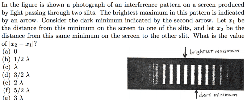

1. The problem statement, all variables, and given/known data
The problem is attached.
I do not know any relevant equations to this matter but I believe that a maximum has the length of λ and a minimum has the length of λ/2.
I see one maximum and one minimum so I decided to add (λ) and (λ/2) together to get (3/2)*λ.
I was wondering if my thought process was correct or not.

Looks like the right answer to me, but your reasoning seems a bit odd. Can you try to be a bit clearer? What do you mean by a maximum having a "length" of λ?

Ok, I'm back.
Draw a diagram, top view. On the left, you have the two slits, one above the other; on the right you have the screen with the maximally bright band, below that a dark band, below that another bright band, then the dark band of interest.
For reference, label the centres of these bands A, B, C, D respectively, and label the two slits U (upper) and L (lower).
What can you say about the distances UA, LA? What about the distances UC, LC?

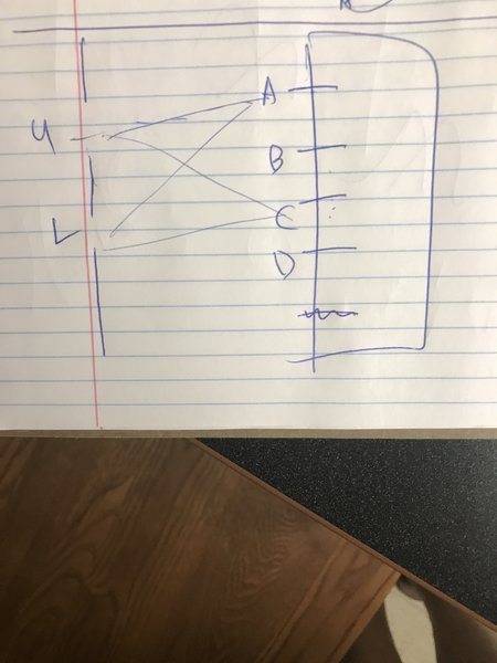

Ok I drew the two diagrams. From my diagram, it appears that the distances form triangles and therefore angles.

Your use of "apart" makes me doubtful. Please post your diagram.
This is what I got.

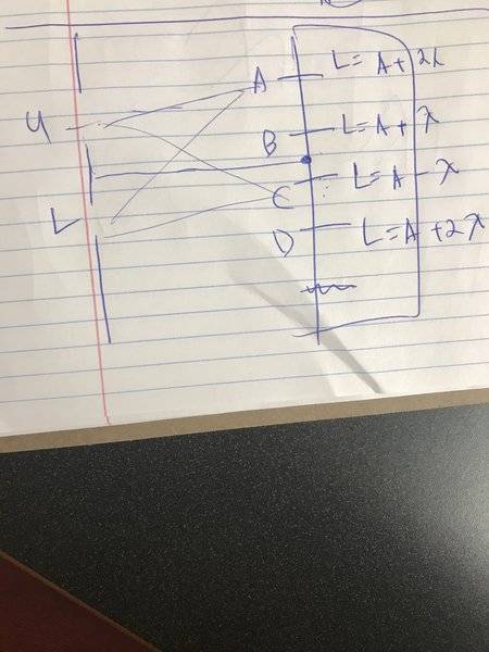

Ok, but what in that are you saying are "2λ apart"? Can you write that statement as an equation using the lengths UA, LA etc. or mark it on the diagram?
I think you are saying your L+nλ are distances from the marked dot on the screen, right?
If so, no.
Let's back up a bit... where should the brightest spot on the screen be in relation to the slits?
