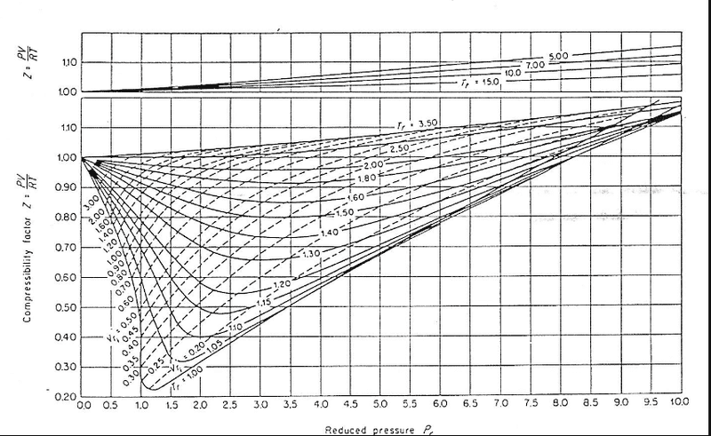

Hello everyone. I stumbled across a problem while studying for my exam that I cannot confidently answer.
Can we assume nitrogen at the temperature of 27˚C and the pressure of 100 kPa an ideal gas? Justify your answer.
The definition of an ideal gas is "...a gas whose molecules are spaced far apart that the behavior of a molecule is not influenced by the presence of other molecules-a situation encountered at low densities."
I know that we can use the compressibility factor to find out if its not an idea gas or not but I am missing the specific volume.
z=Pν/RT
where z is the compressibility factor and ν is the specific volume.
I checked the ideal gas properties of nitrogen table in my book but it doesn't include specific volume.
How am I supposed to know if nitrogen at this temperature and pressure is an ideal gas or not?

Have you ever heard of the principle of corresponding states? What is the value of the reduced pressure and the reduced temperature of N2 in your example? From the graph in your textbook, what is the value of the compressibility factor z?
If fluids compared at reduced pressure and reduced temperature have about the same compressibility factor. I would have to find the actual pressure and actual temperature of the fluid (lets say He) I am comparing it to, then find out if helium at that pressure and temperature is an ideal-gas or not. Wouldn't I be at where I started from but now I'm seeing if helium is ideal-gas or not using the same properties instead of nitrogen?

The principle of corresponding states says the the compressibility factor z is a unique function of the reduced pressure (pressure divided by critical pressure) and reduced temperature (temperature divided by critical temperature), irrespective of what substance you are considering.
Since the compressibilty factor is a unique function of reduced pressure and reduced temperature, that is the only information required for me to find z. Correct?
Chestermiller said:
I see it now, with Pr and Tr, I can find what z is. And I can find Pr and Tr with the given information.
Thank you for your help, I understand this much better now.
